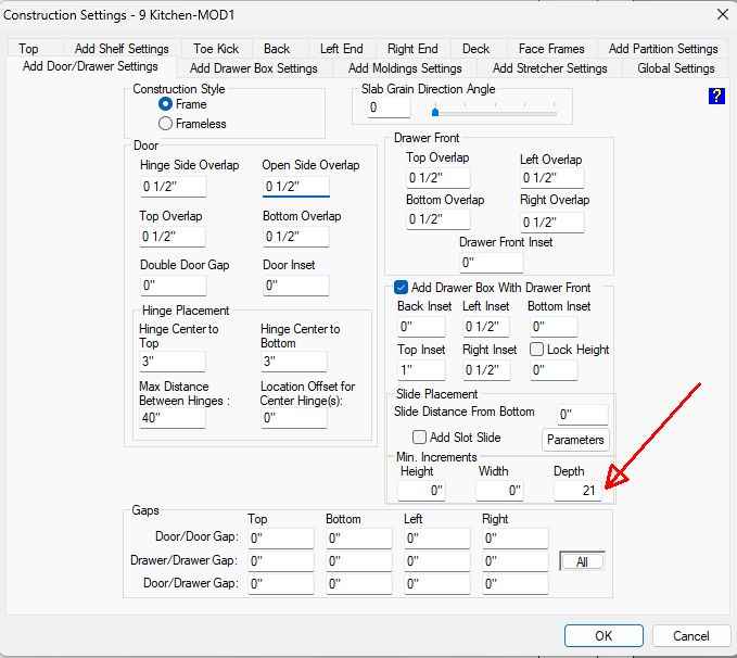

Re: Wouldn't be nice if...
An f(x) function for the depth of a drawer. Most of us probably use drawer slides that need a specific depth drawer box (ie: Blum Tandem undermounts) and when making not standard depths of cabinet or changing a cabinet depth the drawer depth changes also. It would be nice if it remained constant when the depth of a cabinet changes. You can fit a 21" Tandem in a cabinet with a depth of 21 7/8" (internal) or larger.
Leo,
This isn't exactly what you are looking for, but in my library cabinets I set a minimum Increment for depth for the depth drawer I want in Construction Settings/Add Door/Drawer Settings and add drawer box settings. Now if I increase the depth of the cabinet the drawer stays the same.
Leo Graywacz
- Posts: 641
- Joined: Tue, Jan 16 2007, 7:56PM
- Company Name: LRG WoodCrafting
- Location: Windsor Locks, CT
Took me a while to find that page. Mine looks nothing like yours does. I'll give it a shot and see how it works out.
