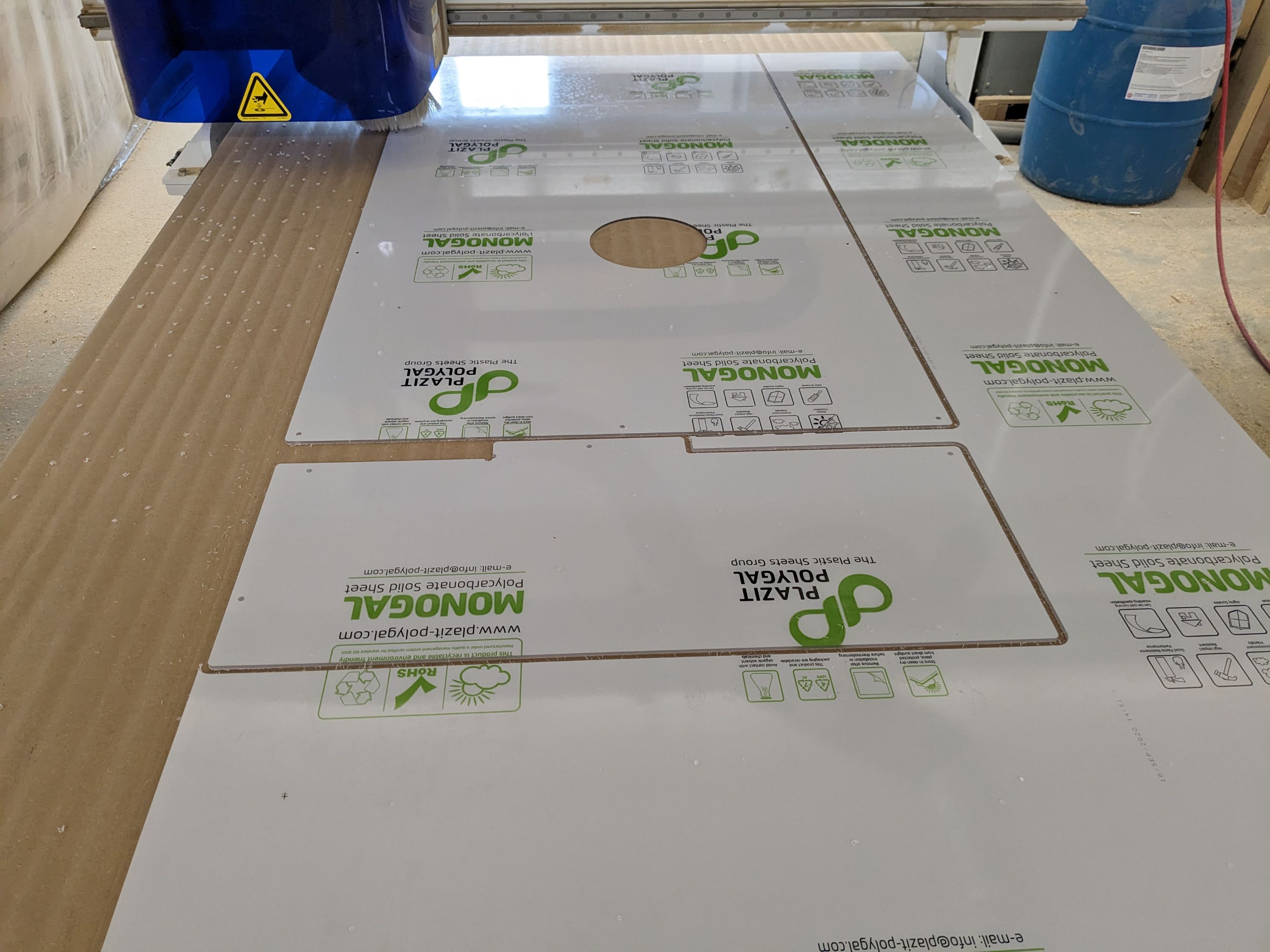

This has happened twice now, and I think I've narrowed it down to the roughing function, identical parts in a plain outline seem to cut fine. For what its worth, I used the rectangular nesting for this. Dxf's with convoluted corners on the outline layer sometimes lead in/out on the inside of the part.
Has anyone else seen this yet?

Should have this corrected for the next version of Control Nesting.
