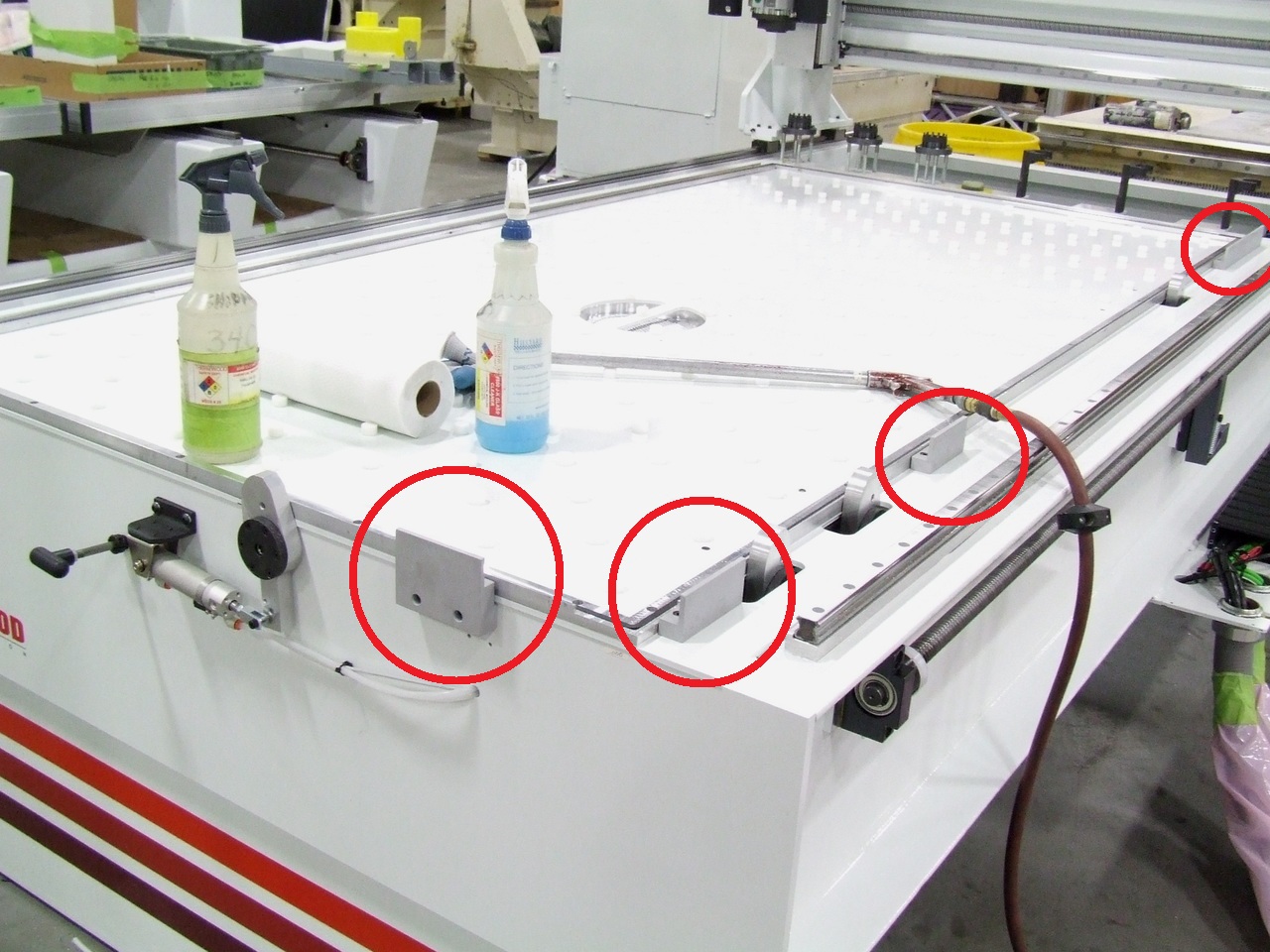

Not sure if they are still there or not, but when the machine was new we installed aluminum brackets on the machine for the flip fence Will linked in his post. Originally we shipped an aluminum L with a black handle bolted to it for single part flip operations that would nestle into two of the brackets. Image attached with the brackets circled in red.

That is exactly what I was looking for, the aluminum brackets are missing but the fence with the black handle (that i couldn't figure out what was for) is still here, all I have to do is machine new stops and I should be in business thank you very much, I wish I would have posted sooner.

You're welcome. Just be careful when doing surfacing so the bit doesn't contact your aluminum pieces. You'll also want to get them bolted on, then do a skim pass on the wall to square them to the machine. Prior to that, make sure the gantry is square to the table so you don't make brackets that are square to an unsquare machine.Lenny Stahl wrote: Tue, Mar 26 2024, 10:04AM Clint,

Clint, That is why, someone probably, took them off.
It would suck, the way I load panels, pushing them on. from the end
As well as if, you were using a handling, board.
