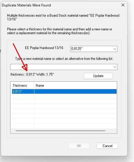

When I try to open THIS JOB
I get a prompt about single material with two thicknesses. After following instructions on the prompt, eCabinets crashes.
I can't find the problem material 0.813 thickness, in my board stock.
Other jobs open fine.
See this YouTube Video
Re: eCabinets Crashes Opening Job

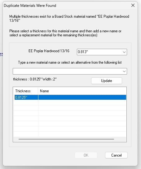

When I select the material with the .813 thickness in the Duplicate Material Found Dialog, it says the material is .813" Thick and 1.75" Wide.
When I select the .8125 material it says the material is .8125" thick and 2" Wide.
This must be a throwback to when eCabinets treated face frame material as moldings and we had to enter every width we used.
