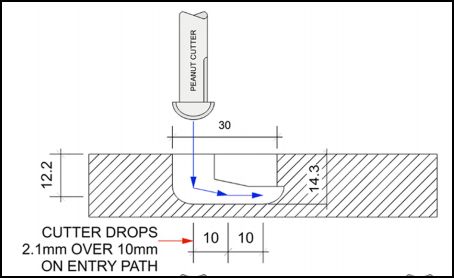

Does anyone know of a way to machine these sloped slots as an RTA fitting?

Contact CNC Automation. It is a software purchase from them. You will need to install to your processor. We have it. The install was very easy and they answered all my questions

Thanks Ian! Never heard of them but I'll give them a shout.
