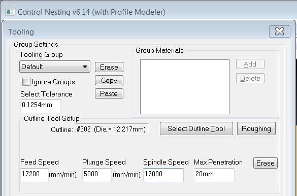

I haven't tried removing and reinstalling, but I don't seem to have the roughing button.

Re: Roughing button missing in CN 6.14
Interesting... I have it. And yes, I agree, this feature will be very useful!
Thanks Tommy, that lets me know that the issue is with my computer. I had a couple programs open when I installed CN, that's probably what did it.
I found why it was missing. I have my Version Override set to 7.0.9 (using THM desktop) because this one writes code for our CS41, which is a 2008 WinXP machine with THM V7. If I change the version override to a newer version, the Roughing button shows up. So, the roughing feature is not available for an older THM version?
Jeremy,
Unfortunately your machine must be version 7.6 or newer for the roughing feature. There was not the necessary AFL code that is required for the roughing to work prior to 7.6. The Control Nesting update page should be updated now to reflect that.
