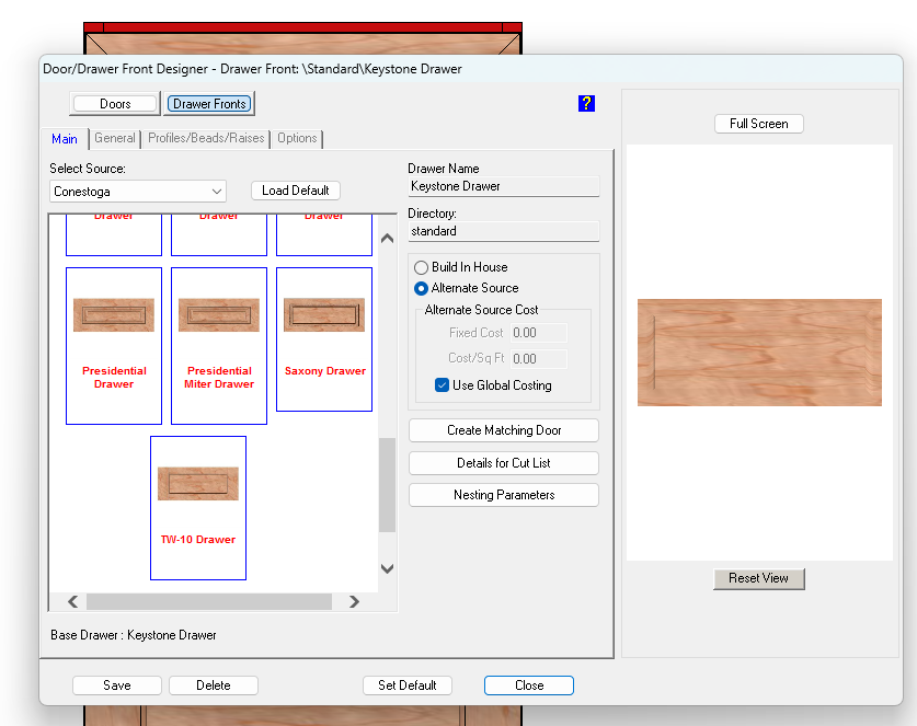

The library of Conestoga drawerfronts that came with the software has sixteen styles. See the pic for the bottom of the scroll view. I need a slab d'front that is Conestoga (outside purchase) and I recall there being one. Where did it go? It is not one of the sixteen.

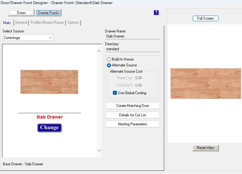

Gene,

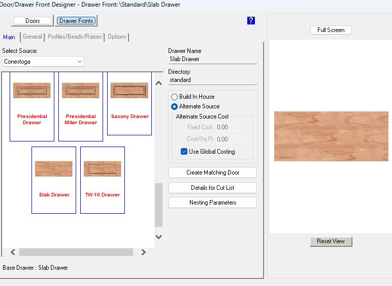

It is in there. I have 17 Conestoga Drawer Fronts.
Go to C:\Users\Public\Documents\Thermwood\eCabinet Systems\drawers\Saved\Conestoga\Standard
on your computer and see if the Jpg for the slab drawer front might have been deleted. If the jpg is not there and the .hsf file is it won't show up in the dr drw editor.
Gene Davis
Posts: 70
Joined: Sat, Sep 02 2017, 7:30PM
Company Name: Gene Davis Builder
Re: Is there a Conestoga slab drawerfront in the library?
Post by Gene Davis »
I is not there and I must have inadvertantly deleted it. How can it be recovered?
I will send the two files and you can copy them to that same file listed above and see if that restores it.
Be certain you don't change either file name
Slab Drawer.jpg (6.53 KiB) Viewed 5988 times
Slab Drawer.hsf
(3.17 KiB) Downloaded 222 times
