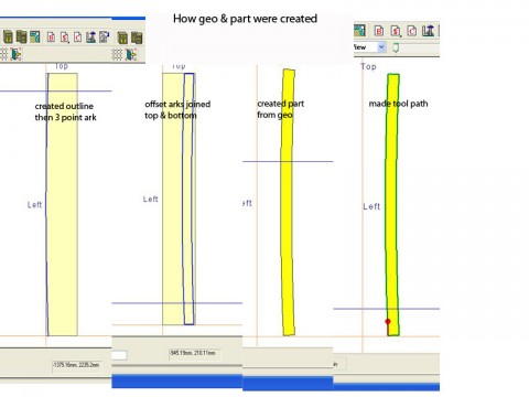

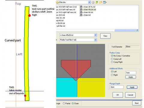

I will email the toolset file to you, the two attachments are of how parts were created and tool path.

Success :beer: at starting on the top edge, climb cut as you look at the part in ecabs,so on the curved parts we’ve made we cant just start anywhere.
