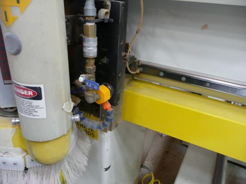

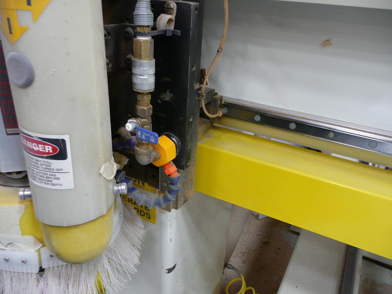

Here are a couple pics of the air nozzles. Our operator says they DO get knocked around by debris, but are easy to realign. We're thinking of making a ring that could be wire tied to the perimeter of the hood with a quick disconnect so the hood can be removed easier.
Any way, it works great for now. keeps the chips air born and the kerf clean.

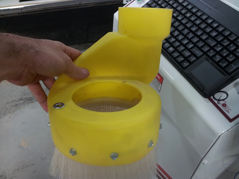

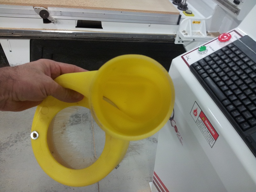

See...the problem is not Vacuum...the Suction is great when the flex tube is disconnected...its the yellow Bowl itself.... was wrongly made...The bowl itself reduces the diameter, and a slot type opening that is not letting as much volume get through as the Awesome C-40's yellow Dust Pick up Bowl. Im gonna keep thinking on this...as i said before... only been 2 weeks im using my new cs-43
Thanks for reply
Thanks for reply
