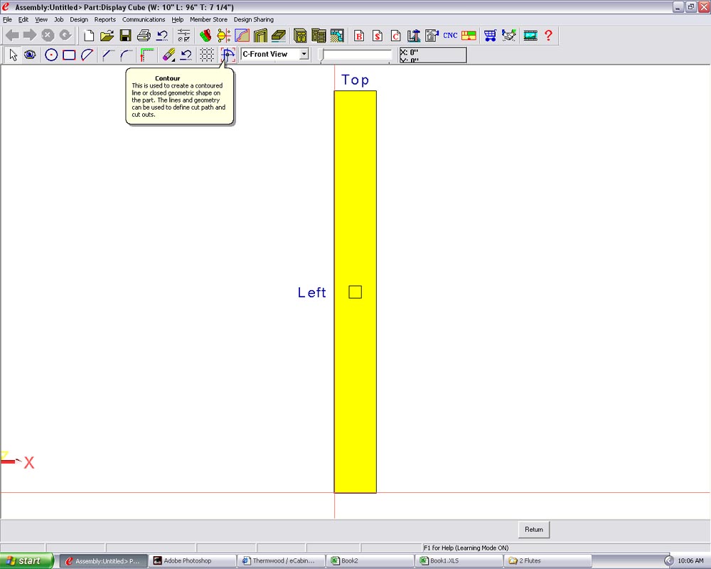

Once you are in the Part Editor, click the Contour Mode icon.

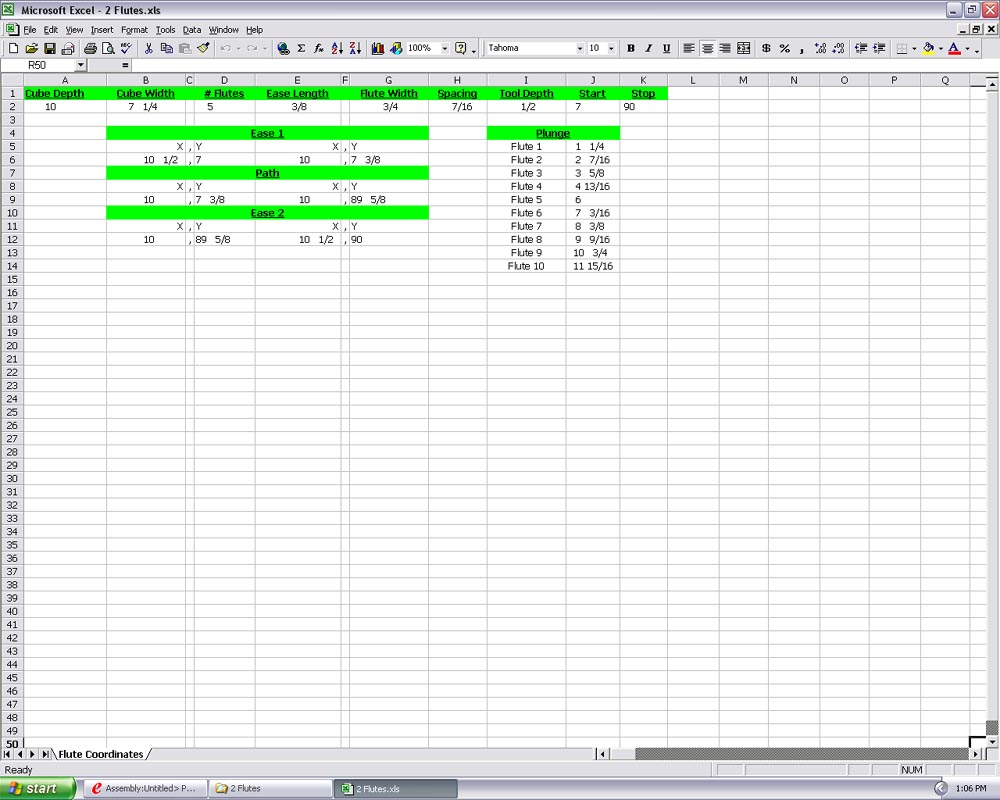

We're going to be using (x,y) coordinates again, and I've written a small worksheet in MS Excel that does all the math for us. It's included here, along with a screenshot.
It's pretty self-explanatory, you only need to input your numbers in the top row. The other cells are all results of the formulas that use your input.
I've decided to make 5 flutes that appear as though they were plunge routed instead of eased. Because our tool is 3/4\" W, we need one half of that width as our Ease Length to achieve this. Any shorter and it looks as though the flutes started 1/2 into the board, any longer would result in eased or 'bullet' flutes. (If that's what you want, play with the Ease Length until you get the desired effect.) For now, we'll make them look plunged.
Please note that in the Excel worksheet my Cube Depth is equal to our desired cube, and width as well. (As opposed to how we reversed them when we first made our Display Cube at the beginning of the tutorial.)
2 Flutes.xls
(15.5 KiB) Downloaded 554 times

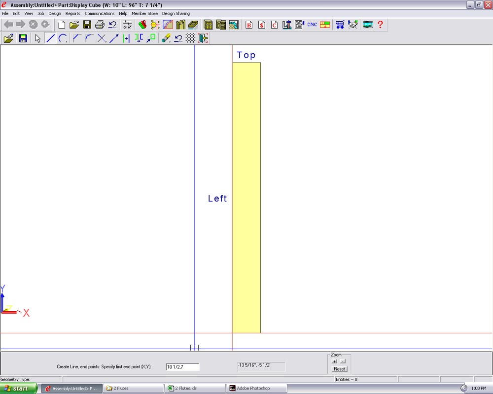

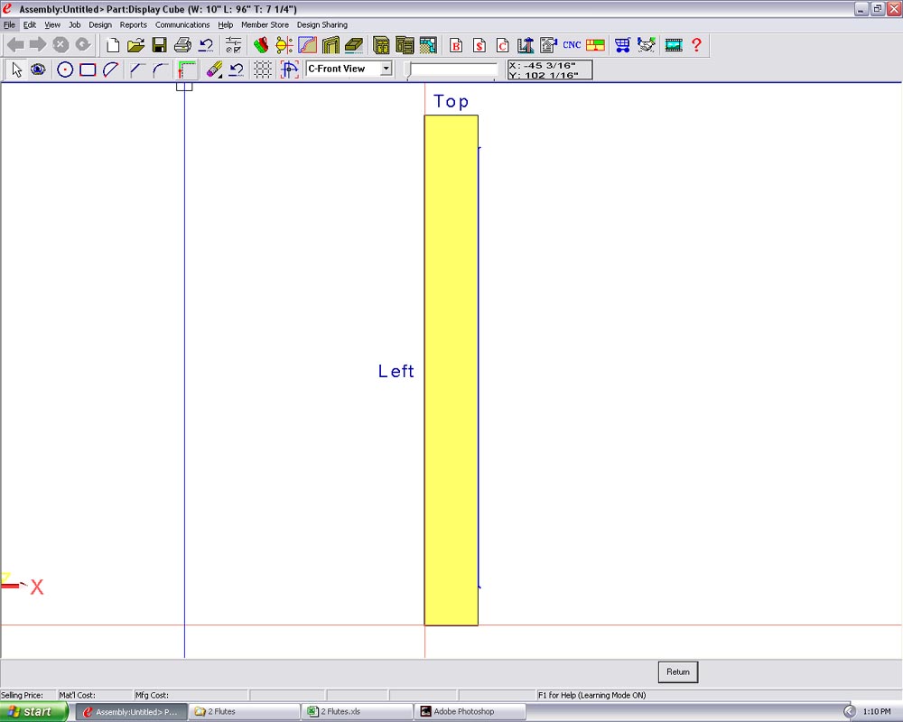

Once you are in Contour Mode, and have used the Excel worksheet to determine your coords, it's time to input them.

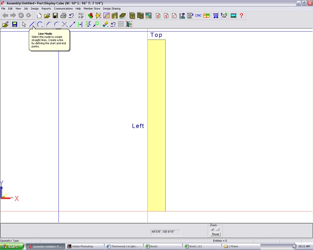

Select Line Mode.
Line Mode.jpg (71.73 KiB) Viewed 11705 times

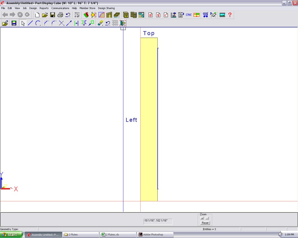

Use the input box at the bottom of the screen to input these coordinates:
10 1/2,7 (enter)
10,7 3/8 (enter)
10,7 3/8 (enter)
10,89 5/8 (enter)
10,89 5/8 (enter)
10 1/2,90 (enter)
Then return to Part Editor.

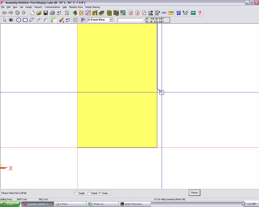

Because our ease path is so short, we'll need to zoom in to select it without selecting anything else. Zoom into the bottom portion of our display cube, choose Chain from the options at the bottom of the screen, then select the end of our ease path.
Select path.jpg (69.71 KiB) Viewed 11700 times
Mike Seisser
Posts: 544
Company Name: NCB Inc.
Post by Mike Seisser »

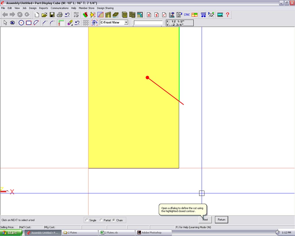

Here is a shot of our path properly selected. Once it's selected, it's highlighted red and green, and a Next button appears at the bottom of the screen. Click the Next button.
Path Selected.jpg (73.51 KiB) Viewed 11699 times

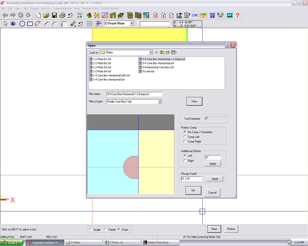

Next, from the resulting popup menu, choose the tool (.tol) file we created earlier. Doubleclick it when you select it, or single click it and then click the View button on the menu as well.

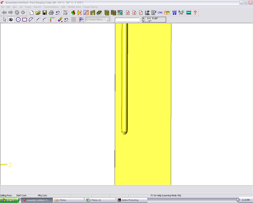

Because we created our tool to work horizontally and centered it's plunge on the X axis, we can create our flutes anywhere on the side of our display cube by simply changing the Plunge Depth on this popup menu.
Refer to your Excel worksheet for the Plunge Depth of our first flute, in this case, - 1 1/4\". Enter it in the Plunge Depth input box, click the Apply button, then click the OK button.

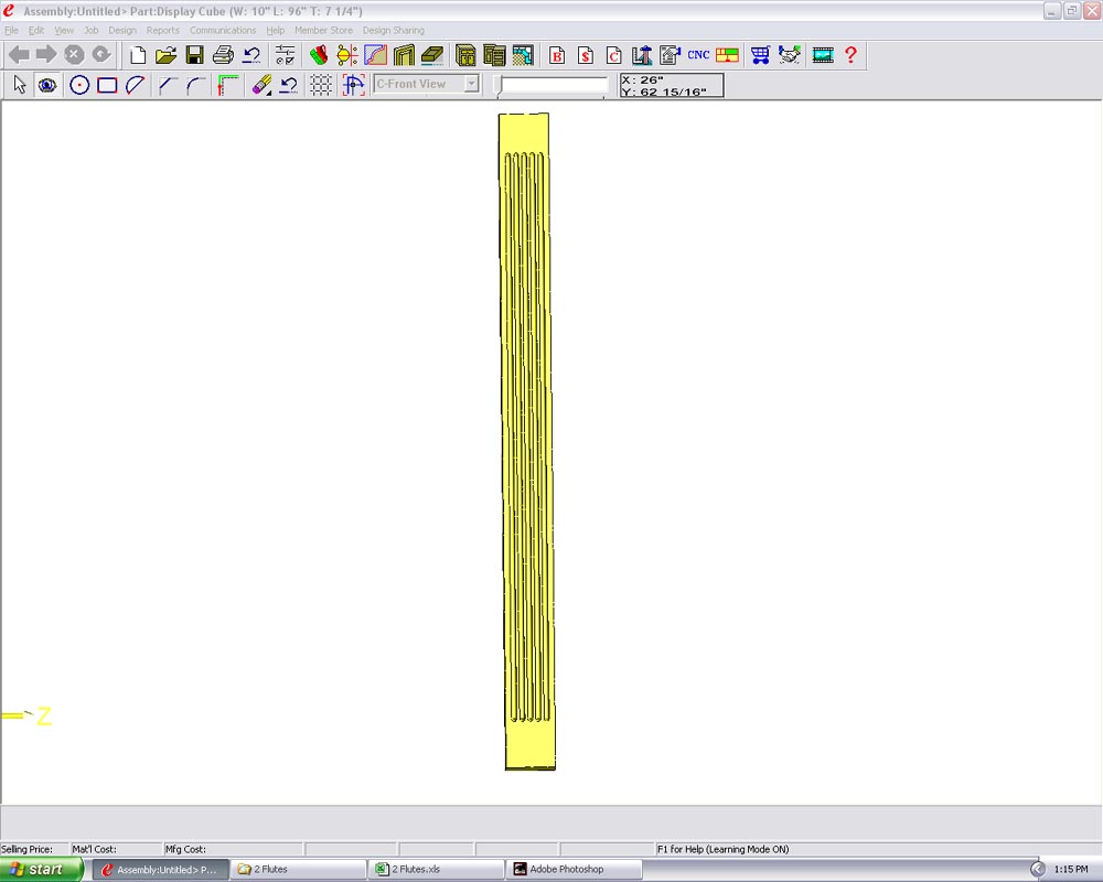

At this point you can preview your flute by clicking on the eye icon and rotating the display cube. Below is the result of our first flute.
1st Flute Result.jpg (60.62 KiB) Viewed 11696 times
Tool with Plunge.jpg (96.92 KiB) Viewed 11696 times

Next, select our path the same way we did the 1st time, select our tool again, and input the Plunge Depth for the 2nd flute (refer to the Excel worksheet again) in this case -2 7/16, click Apply, click OK.
Repeat selecting the path, tool, and inputting your plunge depth using the Plunge Depth from the Excel worksheet until you have completed 5 'passes'.
The result is shown below.
5 Flutes Result.jpg (64.68 KiB) Viewed 11695 times

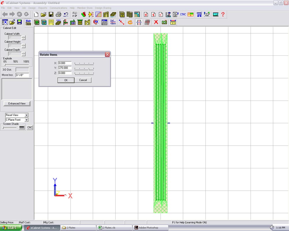

Once back in the Cabinet Editor, select the display cube, right click, choose Rotate Item, and rotate it 270 degrees on the Y axis.
