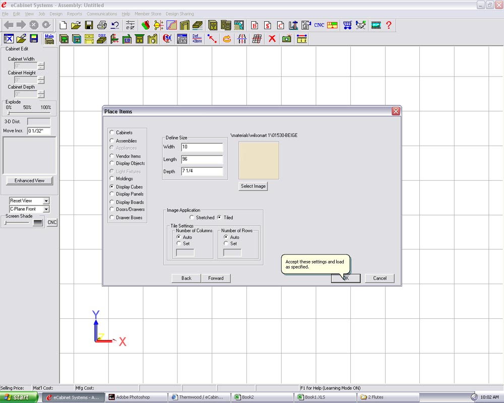

First we make our display cube. Let's say we need a final piece 7 1/4\" W x 96\" H x 10\" D. However, we need to swap our width and depth dimensions when we create the cube because we'll be cutting our flutes from the side. So, enter 10\" for width, 96\" for length, and 7 1/4\" for depth, then click OK.
Display Cube.jpg (106.09 KiB) Viewed 14556 times

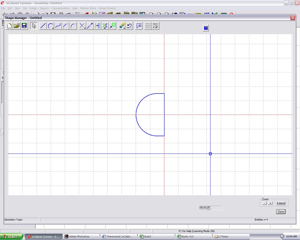

Once you've entered all your coords, your tool outline should look like the pic below.
3-4 Horizontal Core Box.jpg (109.72 KiB) Viewed 14555 times

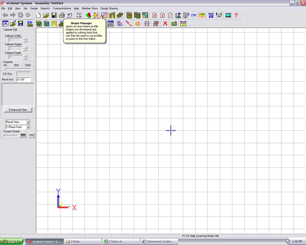

Shape Manager.jpg (106.18 KiB) Viewed 14554 times

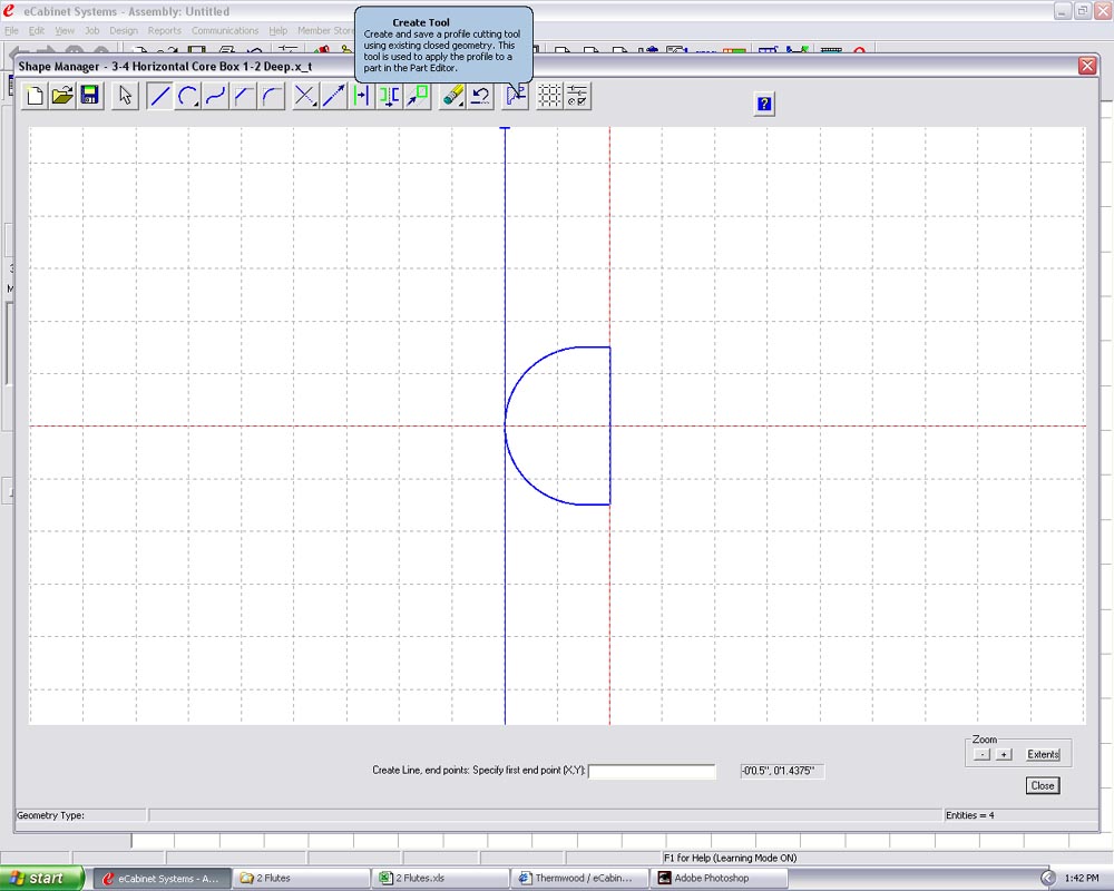

Next, click the Create Tool icon, then click anywhere on your tool outline. A Next button will appear at the bottom of the screen, click it. A pop up window called Set Tool Diameter appears, just click OK without entering anything. The Save As window appears, name your file, remember where you are storing it, and click Save.
Create Tool.jpg (109.98 KiB) Viewed 14552 times

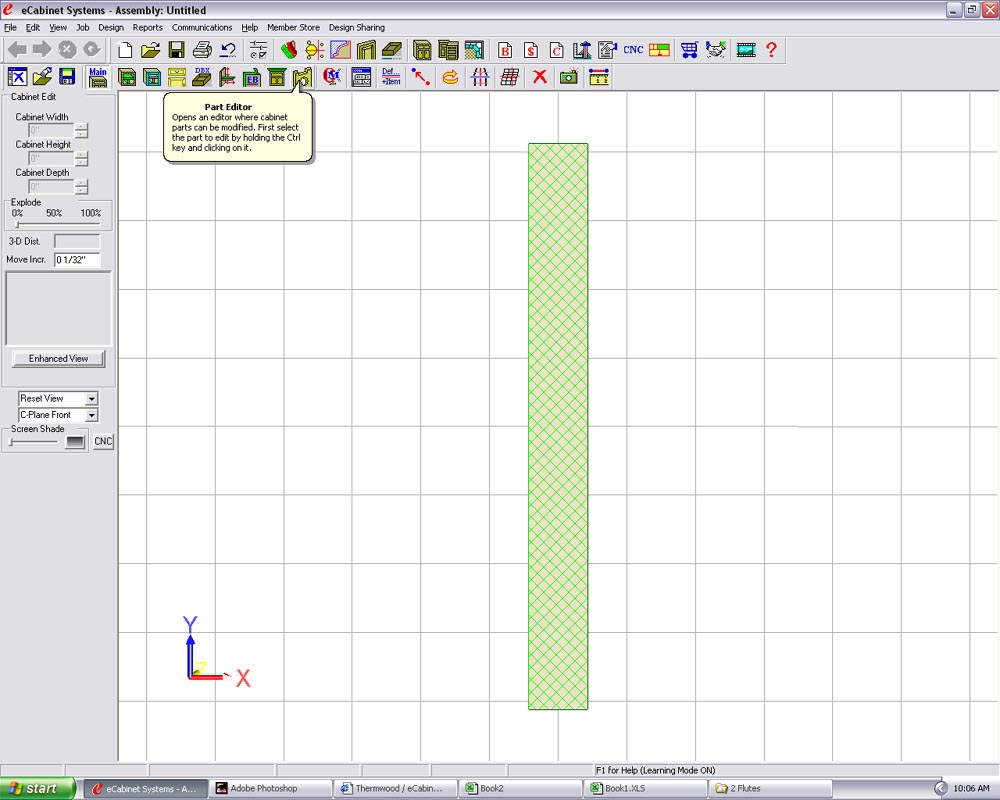

Next, close the Shape Manager, select your display cube, and click the Part Editor icon.
