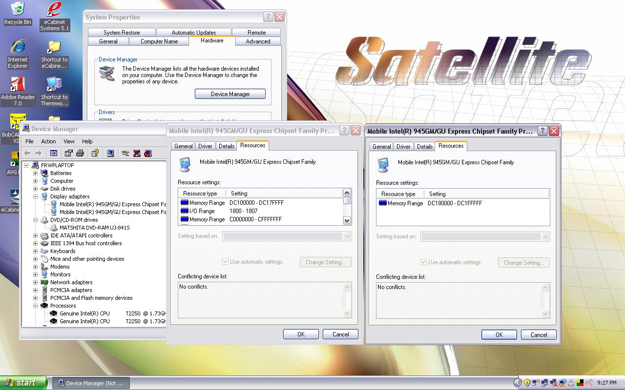

Here's a dumb question. Why does my laptop show two graphics chips?
Joe
Joe,
I am no expert but the device manager looks at some of the dual core processors like they were two separate processors. I bet it has something to do with this.
