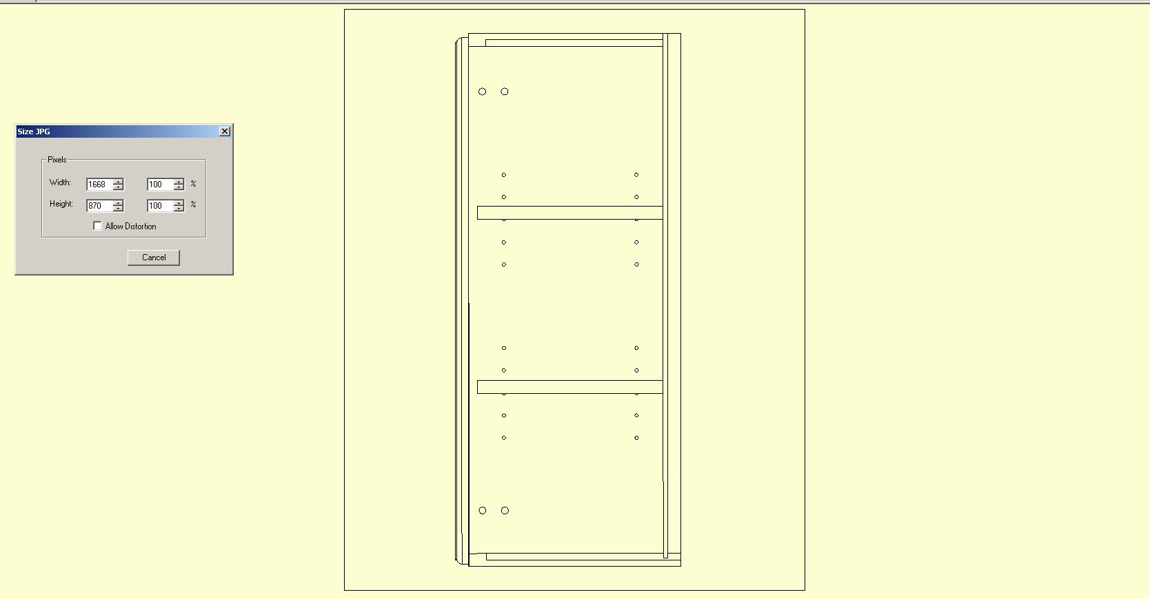

Unless I'm missing something, adding an adjustable shelf already centers the holes--as long as you have the same even number of holes \"up\" and \"down.\"
Here's what I do when adding multiple adjustable shelves. I determine how many total shelf holes I need (must be an odd number to work) and subtract 1. Then I divide the remaining number by 2 to get an equal number of \"up\" and \"down\" holes.
After adding the first shelf I adjust the top opening to make it smaller by half the thickness of the shelf. Then I go back into construction settings and uncheck the box for \"Apply Shelf Holes\" and add the remaining shelves.
This results in multiple adjustable shelves and the holes are centered in the case. They will remain centered unless you move the original shelf from its location.

Hey Dan, the shelf is centered, not the holes, that is what throws the 32mm system holes off if you were trying to truly design balance panels.
Mike Murray
mike@versatilecabinet.com
Re:
Michael S Murray wrote:Hey Dan, the shelf is centered, not the holes, that is what throws the 32mm system holes off if you were trying to truly design balance panels.
That's why you subtract 1/2 the thickness of the shelf. The shelf sits on top of the center hole. By subtracting 1/2 the thickness you effectively move the shelf so it is centered over the top of the hole. I suppose it would actually be more precise to also subtract 1/2 the hole diameter so the center of the shelf is over the center of the hole.
Of course the actual shelf isn't displayed over the enter of the hole, this just offsets the hole locations by that amount.
Gene Davis wrote:Will it work for him if he resizes his seed cab by changing height of cab?
Not without adjusting the opening above the shlef that "owns" the holes.
Bear in mind that all joinery is "owned" by a cabinet part. Changing that part changes the location of the joinery, or holes in the case.
