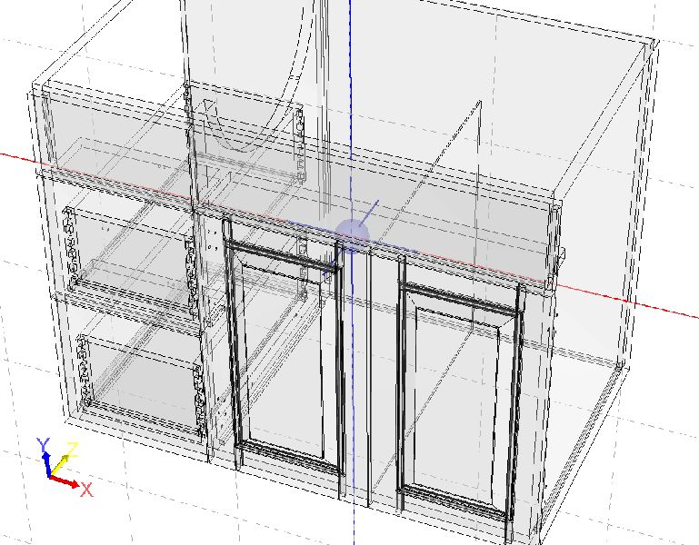

There is another reason for using the "false" or "shadow" partition for managing a pair of doors in a single frameless opening. The pic here shows a 36-wide vanity, in which the LH door hangs to a single partion, and only overlays that partition 8.2mm. The RH door is hinged to the R side, and overlays that edge 17.8mm.
The "do not cut" partition is placed so that the doors are equal in size, but because each is separately placed, each can have its own and different hardware pack associated with it.
Thus, the LH door has a 6mm hinge plate, and the RH door has one at 0mm. These hinge plates yield the desired overlays.
A double door placed into a single opening can only have one hardware pack associated with it.
