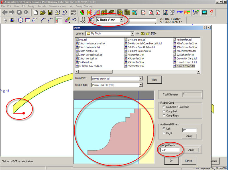

Here are a couple more images to show what you need to do.
I started with a display cube, 96W 22L 3D and placed two circles on it in Contour Mode. One circle has a radius of 72.25" and the other was 69.25" so the part would be 3" high. You have to use two circles instead of copying a three-point arc to preserve a consistant part height.
The part was flipped (C-Back View) in the Part Editor and the tool path was started at the bottom left. Then I used the tool in the first image, set the plunge to -.5" (negative 1/2") and left offset at 0".
I could have made the tool so that it did not require any plunge setting but I was just experimenting (see, I do that too :wink: ).
Here is a better description of tool paths, plunges and offsets:
The image in the tool placement dialog is an end view of the part from the tool path starting location. If tool path starts on the left, you are looking at the left end of the part. If tool path starts on the right, you are looking at the right end of the part.
Tool path bottom left
Part is blue
Plunge moves away from face
Left offset moves toward top
Tool path bottom right
Part is yellow
Right offset moves toward top
Tool path top left
Part is yellow
Right offset moves toward bottom
Tool path top right
Part is blue
Left offset moves toward bottom
Hope this helps.
Garys Crown Tool Selection.jpg (93 KiB) Viewed 111008 times
Garys Crown.jpg (25.38 KiB) Viewed 111007 times
