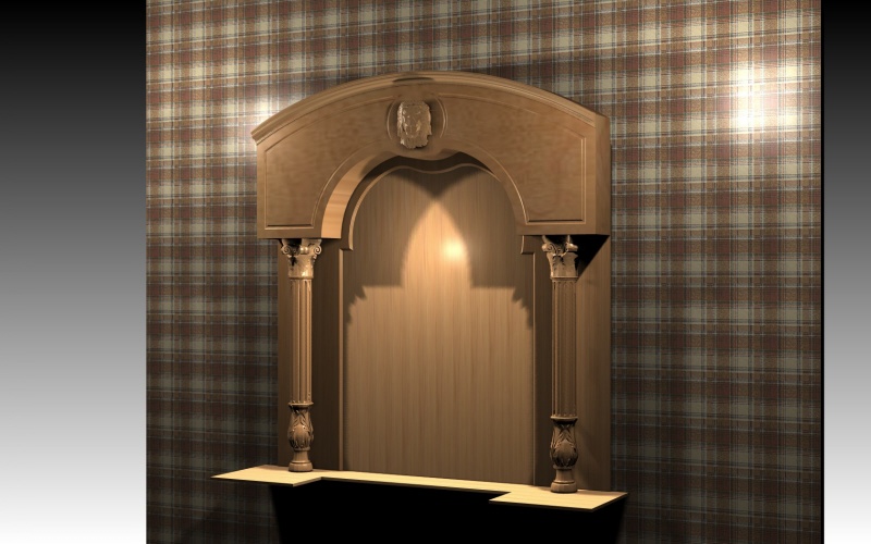

Ok I kind of figured out how to make the turn with the crown mold, now I would like to know how canyou edit a tool because the tool I have is fine it just cuts upside down on the part.
I am trying to make the crown mold turn and return to the wall on the sides
Tom Bates Top Mantel REV3 Thermwood.jpg (113.67 KiB) Viewed 147356 times

Loose the plaid wall paper. You have a nice looking mantle but I don't see anything but the wall paper. :P

Damon Is this better?
Gary :beer:
Tom Bates Top Mantel REV3 Thermwood.jpg (66.36 KiB) Viewed 147323 times

Gary Puckett wrote:Damon Is this better?
Gary :beer:
C'mon dude,...subtle is in and subtle that is not. :joker:
Re: Looking for a tool for mitering
Post by Gary Puckett »
OK so my interior decorating skills needs some work :joker: But trying to wrap this darn crown mold around the sides Is driving me crazy and getting the cutter to cut right

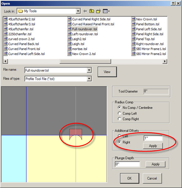

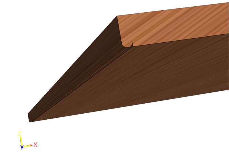

I'm not sure exactly what you mean by "...it just cuts upside down on the part..."
Can you post an end view image of the part with the profile and an image of the tool in the tool selection dialog with offsets and plunge set (like these)?
edge Profiling 7.jpg (32.93 KiB) Viewed 147288 times
edge Profiling 8.jpg (63.08 KiB) Viewed 147289 times
