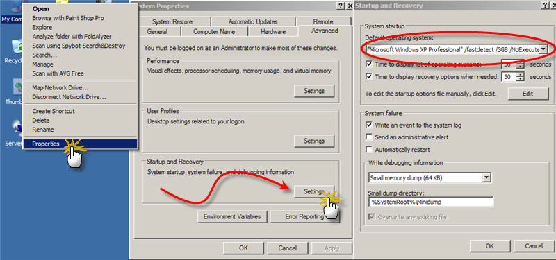

That is correct, it is partitioned. What you read concerns how Windows automatically partitions virtual address space.
If you have the /3GB switch set for startup, you will get the 3GB/1GB partitions. Otherwise, you get 2GB/2GB. This can only be set on Windows Server 2003, 2000 Datacenter Server, 2000 Advanced Server and XP Professional (so those who are reading this and are using XP home: you are out of luck :wink: ).
To set (or check) the startup switches, right-click on "My Computer" and choose "Properties." On the dialog that is displayed, click on the "Advanced" tab then the "Settings" button in the "Startup and Recovery" section...see attached screen grab:
Windows Startup.jpg (65.67 KiB) Viewed 16365 times
What you want it to say is "Microsoft Windows XP Professional" /fastdetect /3GB /NoExecute=OptOut in the dropdown. If it doesn't, click the "Edit" button and you will see the boot.ini file in Notepad. It will look like this:
[boot loader]
timeout=30
default=multi(0)disk(0)rdisk(0)partition(2)\WINDOWS
[operating systems]
multi(0)disk(0)rdisk(0)partition(2)\WINDOWS="Microsoft Windows XP Professional" /fastdetect /3GB /NoExecute=OptOut
Just edit to add "/3GB", save and reboot. Be aware that the multi(0)disk(0)rdisk(0)partition(2)\WINDOWS may be different on your system--DO NOT CHANGE IT OR YOUR SYSTEM WILL NOT BOOT!!!
