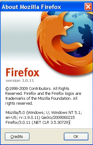

Here it is --

one more question for now. What version of Internet Explorer are you using?

Daniel Vonderheide wrote:one more question for now. What version of Internet Explorer are you using?
I use mozilla

Mozilla or not, the software uses IE when displaying that html file. I came across a web page where people where discussing the same error and it has to do with service pack 3, IE 7 or 8, and some inventory software. Below is the lilnk. I'll keep looking for more info.

Daniel -- You were right on. I downloaded IE8 and it's updates and now it prints and gives me a print preview.
