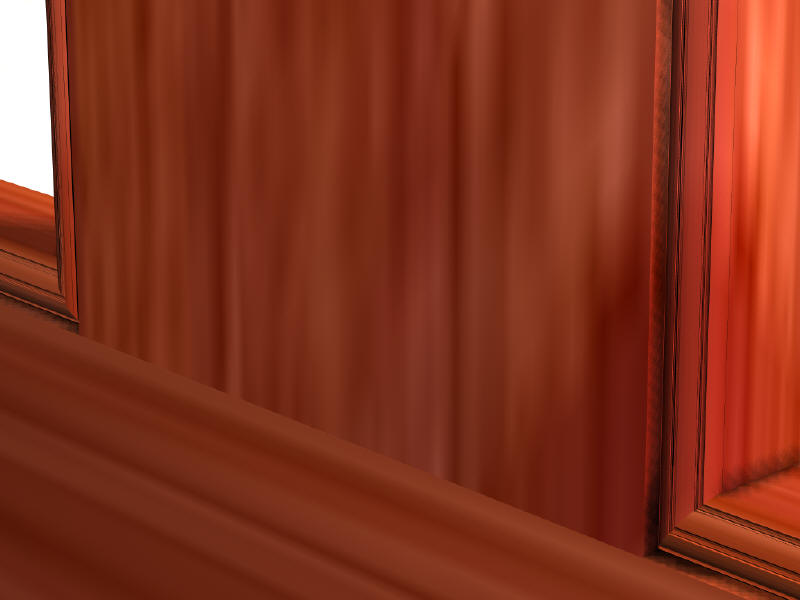

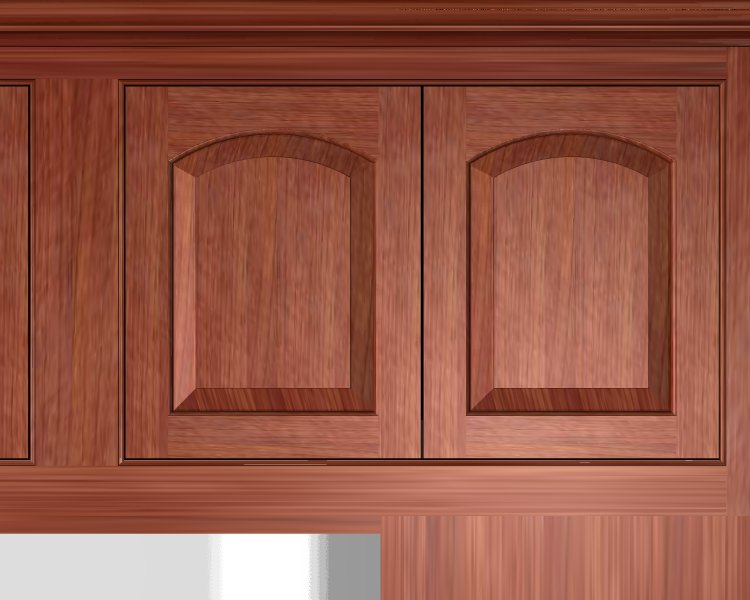

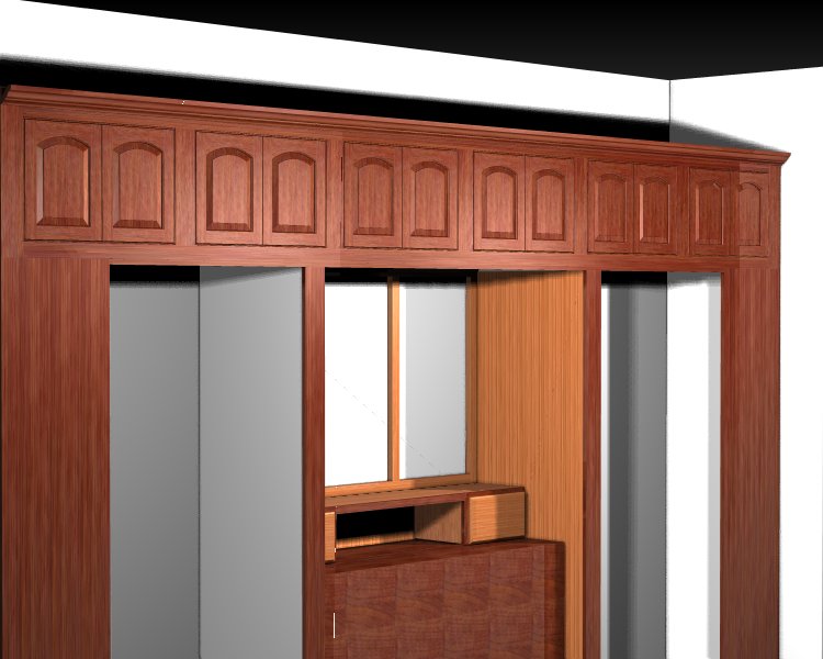

Hi Dennis
I have to give you 5-"STARS" for the haunched and beaded face frame videos.
I would like you to take the rest of the day off
It makes it very easy to do with your videos

I made a master bedroom cabinet with a build in headboard in it years ago and I wanted to make beaded face frame in e-Cabinets for it.I was not sure how to do it. But Dennis made it very easy for me to do today
