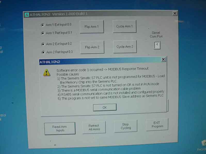

Just looked on the desktop on the control and there is a box that says [ATHALIGN2 software error code1 occured MODBUS response timeout] is this helpfull.
A photo can be Emailed if nes
Thanks Stephen

Hi This is the screen photo
Stephen

Hello Stephen, I am a little confused on why the ath align program is up in the screen shot. That needs to be closed unless you are aligning the tool arms. Is the router spindle stopping during a cut? Does it go into emergency stop when this happens? If so, go the the plc screen and see what the error message is. Thanks

Yes the spindle stops and continues to plough through the job so we estop it ourselves this happened on Friday, so the error message what is in the photo the only thing we have seen,we have ran this program 50mm above the bed and that runs ok, but when running for real it stop on ramp in, so we dare not operate the machine while its like this.
