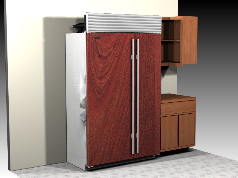

Sears Scratch and Dent Warehouse Reg $1200 Sale $100.00
Sears Scratch and Dent Warehouse.jpg (58.68 KiB) Viewed 6160 times

Post by Dennis Englert »
You'll see these symptoms if your Level of Detail Settings for Custom Layout is turned down or possibly, if your graphics card is just not up to the task. The latter is speculation. You'll get similar unusual looking parts in the Cabinet Editor if the levels are set low. On a side, but related note, one customer installed adjustable shelves but could not see the shelf pin holes. He spent quite a bit of time pondering and redoing. It boiled down to the Level of Detail Settings. He was doing everything else correctly.
Dennis
