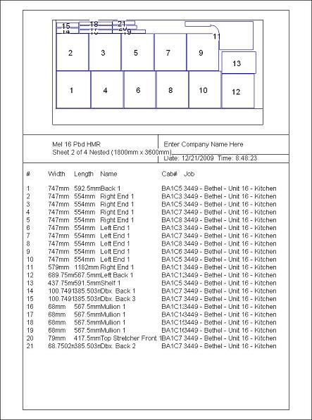

The Export sent in has a job loaded that was not included in the emails. I am having a problem locating what your are talking about. Please offer me precise detail. With the Export Blake sent in I get the attached Sheet 2 results. He stated that the problem exists on the second sheet. So in this example we will use Part 2 as our test. Part 2 on Sheet 2 is the "Right End" from Cabinet "Unit 16 - Cab 2 - Cnr Unit" in job "3449 - Bethel - Unit 16 - Kitchen". The size it is cutting is 554mm along X axis and 747mm along Y axis. Is this correct or not?
Sheet 2.JPG (57.25 KiB) Viewed 25345 times

Just another note on this issue. All the jobs that you have sent in for this have had edgebanding on the parts. The sizes are cutting correctly based on this edgebanding. Please insure your measurements are based on the part size giving allowance for edgebanding thickness.
