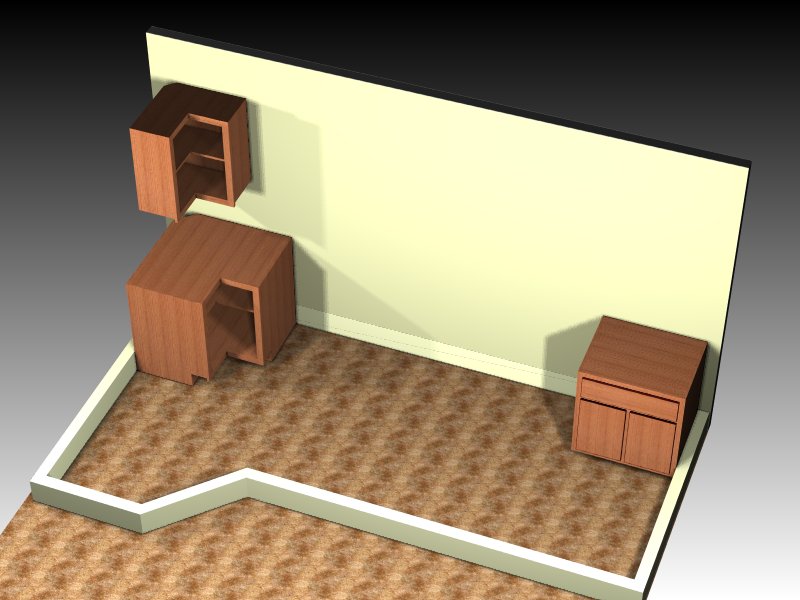

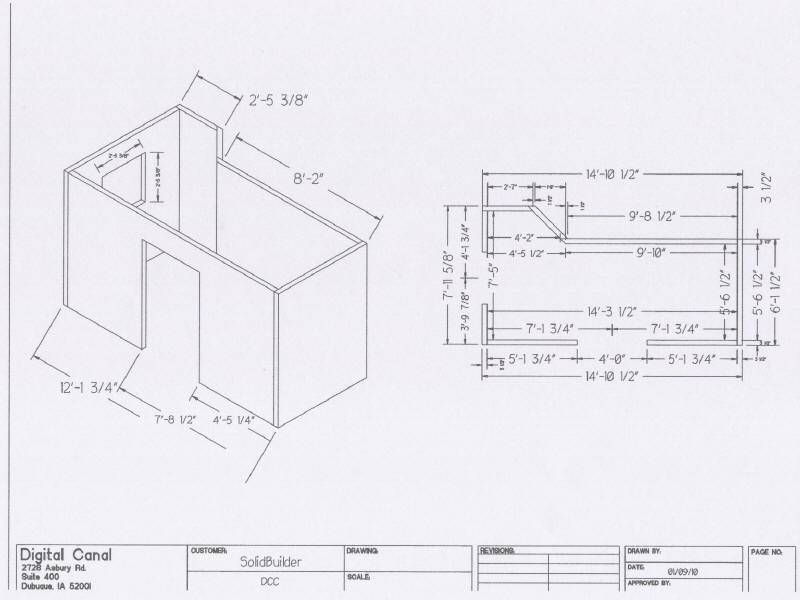

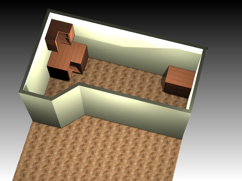

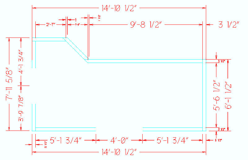

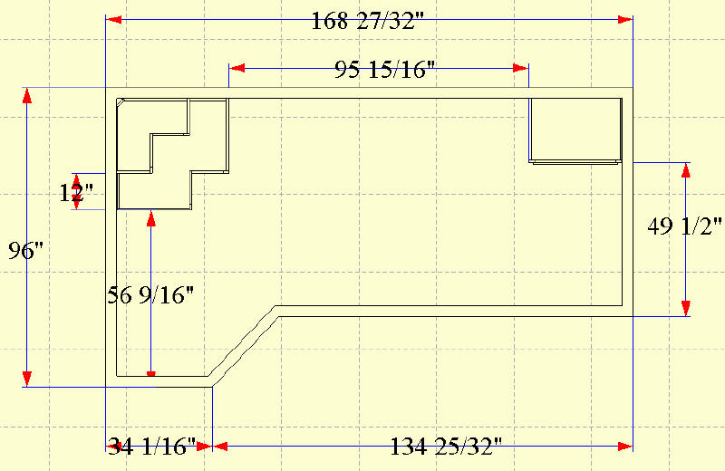

Some times I will make one up in SB take it out of SB as a DXF put it in a CAD program then turn it into a STL file and put it into e-Cabinet as a STL
