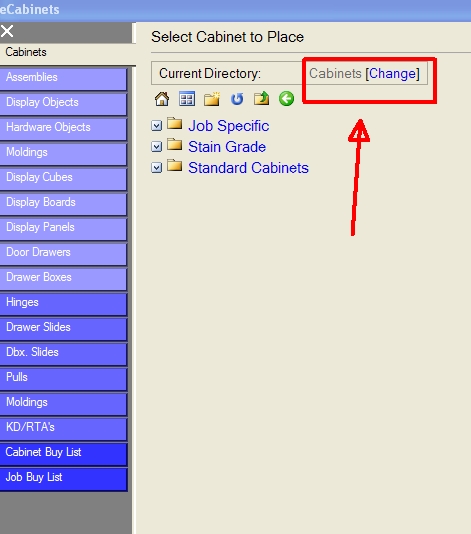

You might click on the cabinets tab in the item window then click on "Change" by the Current Directory and see if the path to the directory is correct.

The path is right, in that it goes to the correct folder that holds my directories. The problem is that the first time I go to save the cabinet, the default 'save to' location is the first directory in that folder, not necessarily the directory (in that folder) that the cabinet came from. Make any sense?
