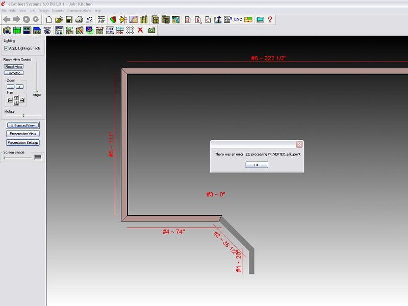

Well I just started my first project in e-cabs after upgrading to V6 & I have 2 issues in the first 2 minutes.
1. Error 22 - See attachment . Anyone know what this is? It happens when I went to the render mode. If I click OK it goes into the render mode as normal.
2. When trying to change the floor texture it will not respond to changes to the Manual Tile vs auto tile etc function. Has anyone else noticed this ?
I'm thinking I should have not upgraded until the bugs were sorted out.
Error 22.jpg (42.18 KiB) Viewed 4765 times
Rob

Rob Perry wrote:Well I just started my first project in e-cabs after upgrading to V6 & I have 2 issues in the first 2 minutes.
1. Can you give some steps on how to reproduce this error?
2. If Hoops Display List is turned on, it will not change until you leave and return to the render view. (Hoops Issue)
You can turn the Hoops Display List off in Settings/Preferences. (may require ecabinets restart)

Rob,
Can you post this simple layout as a job so that we may try to reproduce your error?
So far, I am unable to see what is going on when trying to reproduce this on my system. Hopefully, after getting your job, we can pinpoint the issue and have it fixed.
