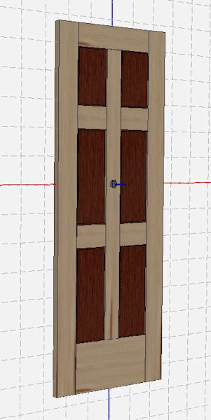

Well, at this point you won't be able to do a re-sizable "door" with a mid-style in the software. What I have done to simulate doors with mid-rails that re-size is to make a door out of a face frame and then use a slab door of the desired thickness for the panel. I then inset the door (panel) in the Door Editor and use negative overlaps.
You can also just take a flat panel door and place in on a cabinet and then use a display board for the muntin. but that will not resize.
I have included an example of a passage door. This uses a 1 3/8" thick faceframe.
Joe

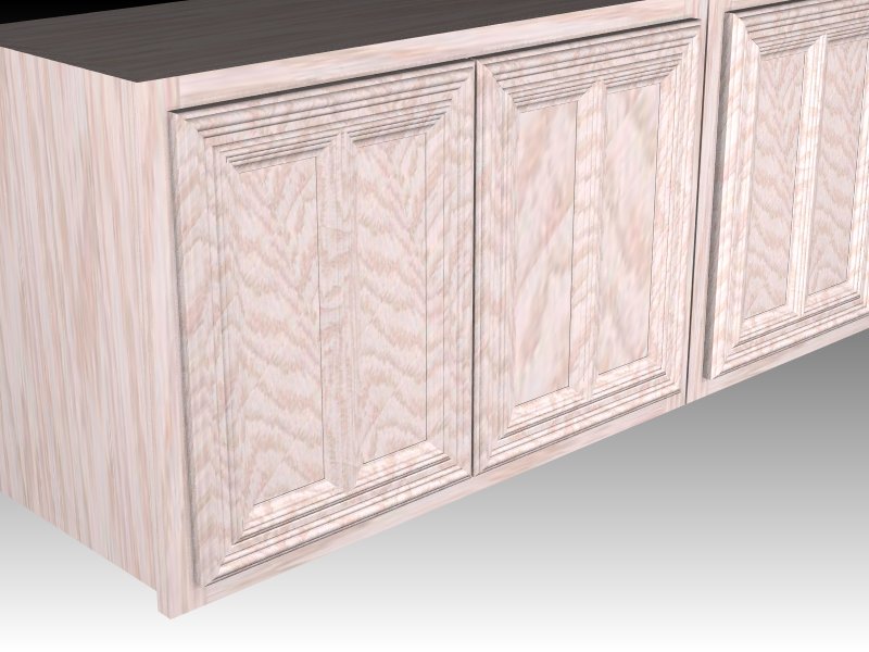

Post by Glenn Warner »

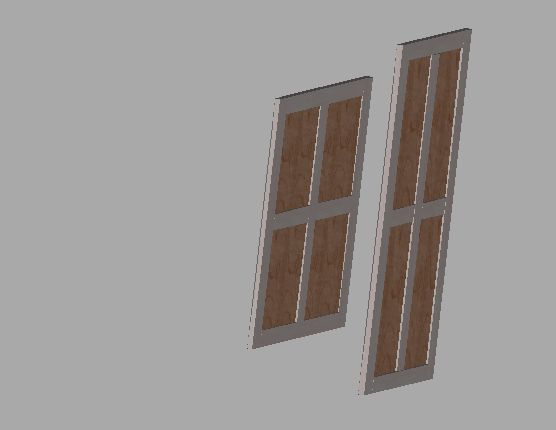

OK. I figured out how to make the panels. Place drawer fronts in each opening. Drawer front material 1/4" stock. Rotate grain 90 degrees. Inset the drawer front 1/2" so the panel is centered in the frame. Set offsets to negative 1/4" on all sides so the panels are over sized.
Here is the result, the same cabinet in two different sizes.

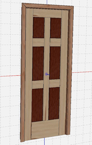

You can also use this method to create pre-hung passage doors. Sorry, I don't have any door knobs.
Joe

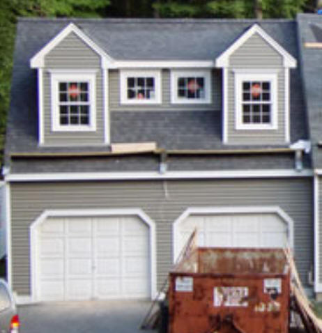

Re: Need to make a door with a center style
I was going to make some of the doors that you have order.
I was going to make them up in STL Files. That way you could resize them to show the customers doors on e-Cabinet cabinets.
I had to take a break from the garage I am doing for a customer
I showed them a picture of one we did years ago they would like to put it on there garage

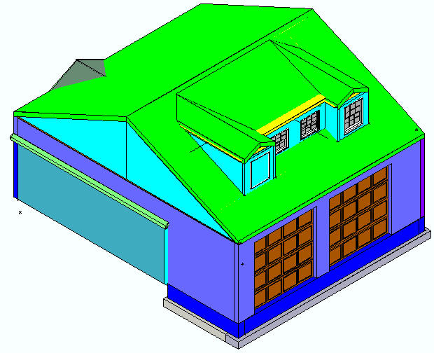

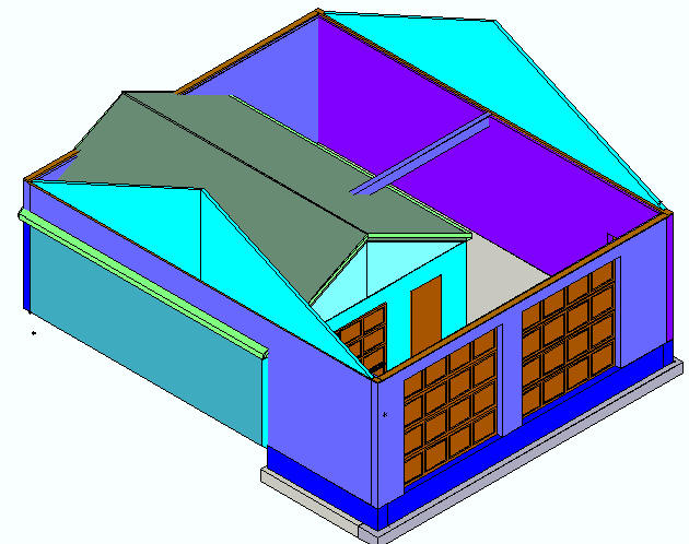

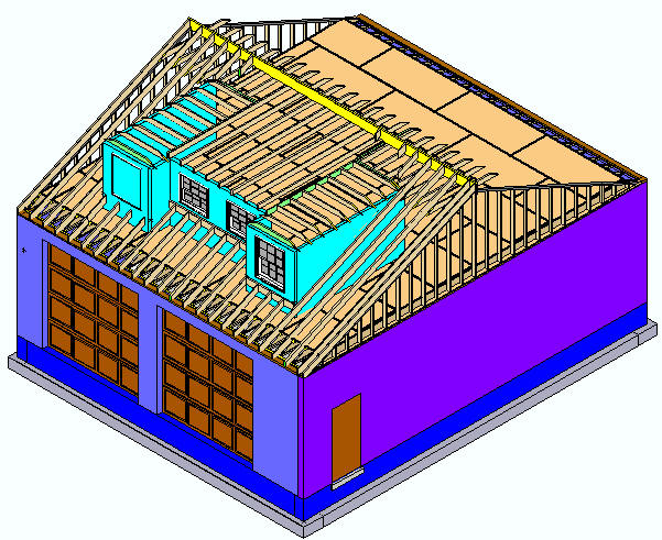

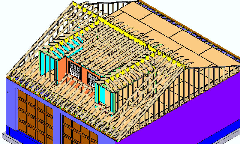

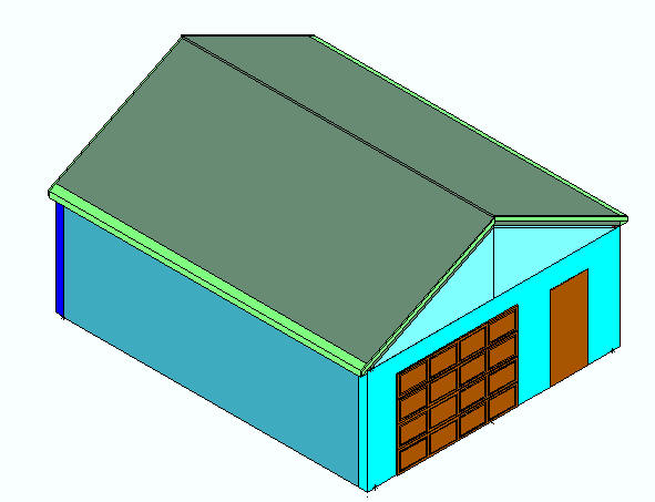

Here is what the garage looks like now and what it will look like.
New garage 30' W x 36' D Block 11' to top of roof 19'-6 3/8" from new pad.
This is why I show all our customers in 3D that is why I like e-Cabinets so much they can see before and after.
Why I show it in 3D the job is 90% sold all you have to do is sell 10% then you can go have a :beer:

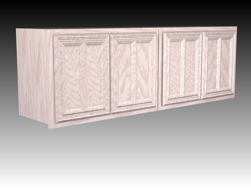

I have made a Library of D-Doors
Here is just one of them Cab._27 x 18 x 24 (STL D-Doors) Cab has 1-1/2" R&S
I HAVE TO GO BACK OUT IN THE SNOW NOW
