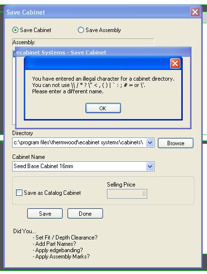

I have just began the transition from V5 to V6 on our office computer and thought it would be a good chance to refine our library. I can't save any cabinets. I either get a HOOPS error or another error saying 'You have entered an illegal character for a cabinet directory. You cannot use !@#$%^&*()' etc etc. There are no such things in the directorie names. Can anyone help me out here on whats going on.
Dale
problem saving cabs.JPG (43.09 KiB) Viewed 13092 times

your directory starts with C:\ and you have to take all that stuff out from in front of your file name.
It does that in V6 and it is a pain. I hope it is on the list for build 2.
Anyway back all that beginning stuff out and just put your file name in it and it will work.

I don't see how you could get your V6 to go into a directory in C:\Program Files...
My V6 really only wants to play with cabinets in "C:\Documents and Settings\All Users\Documents\Thermwood\eCabinet Systems\cabinets" which got created during installation.
The trick is, you can make subdirectories inside this directory, but only 1 level deep (none of your subdirectories can have subdirectories).
So, you can make a directory "C:\Documents and Settings\All Users\Documents\Thermwood\eCabinet Systems\cabinets\My Cabinets" and just copy your cabs into this directory in Windows Explorer. Then when you are in the CE, you can change to this directory in the new side menu thingy, and you will see all your cabinets...
Same goes for "C:\Documents and Settings\All Users\Documents\Thermwood\eCabinet Systems\doors" or "C:\Documents and Settings\All Users\Documents\Thermwood\eCabinet Systems\drawers" (or assemblies, or drawer boxes, and so on)

Kenneth is correct it is the C:\ that is causing the problem. Just name your directory something simple that defines them for you. Don't use the path to the directory as the directory name.
Rob is also correct. Your V6 cabinets will not save to the C:\Program Files etc. path it will be C:\Documents and Settings\All Users etc. path that he states.
