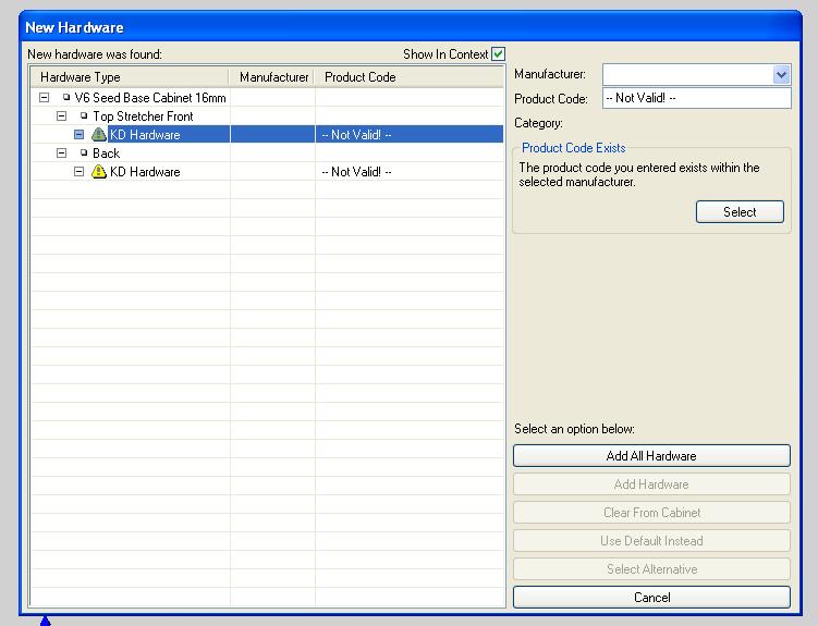

Since upgrading to V6 and when opening some cabinets I keep getting prompted to add new hardware. So I click 'add all new hardware' but it never seems to work and when I go to open the cabinet again I get prompted to add hardware again. Why is the system asking for this when I had it all set properly in V5? It appears to me that eCabs maybe can't find the piece of hardware associated to the cabinet.
Any help much appreciated
Dale
New Hardware.JPG (60.39 KiB) Viewed 16452 times

Ultimately I don't want to have to associate a piece of hardware to anything but only a hole pattern. We see all that is important is the hole pattern and don't want to mess around with selecting maunufacturers of hardware etc etc. With hinges you don't have to specify a product for your hinge and can choose to solely specify a hinge pattern. This suits me fine. When I comes to selecting the KD/RTA settings for a cabinet there appears to be no setting or option where you can clear the hardware and just leave a hole pattern. Does anyone know if this can be done?
Dale
Ryan Callahan
Posts: 587
Re: Add new hardware ?
Post by Ryan Callahan »
Dale,
Can you post a sample job or cabinet that is causing this.
I think this error may have been resolved already, but I would like your case to verify for sure.
Thanks.

Dale Wills
Posts: 190
Joined: Mon, Oct 10 2005, 11:09PM
Company Name: none
Country: AUSTRALIA
Location: Camperdown, Victoria, Australia
Post by Dale Wills »
Ryan,
Attached is one of the spoken cabinets I'm having trouble with.
Cheers mate,
Dale
Base Cabinet 16mm.hsf
(368.02 KiB) Downloaded 865 times

Ryan Callahan
Posts: 587
Dale,
Your cabinet loads fine with all hardware being added as expected. Thanks.

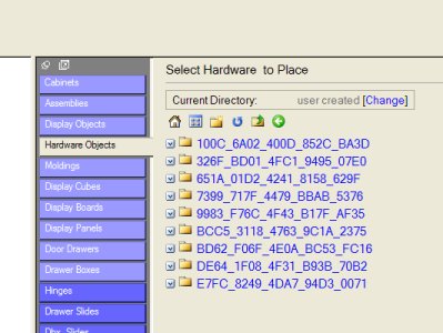

When I try to Define Hardware Categories, the system creates som odd looking subfolders are follows:
C:\Documents and Settings\All Users\Documents\Thermwood\eCabinet Systems\hardware\user created\100C_6A02_400D_852C_BA3D
C:\Documents and Settings\All Users\Documents\Thermwood\eCabinet Systems\hardware\user created\326F_BD01_4FC1_9495_07E0
C:\Documents and Settings\All Users\Documents\Thermwood\eCabinet Systems\hardware\user created\651A_01D2_4241_8158_629F
Now when you are in the hardware catalogue editor the categories are listed as the names that I elected.
Then I create a new hardware part called ADJ-LEG and save it into a new category I just created.
After I try to select the new piece of hardware and associate it with a cabinet,two problems emerge:
a) The names of the new category are not displayed in the selection pane (see diagram)
b) The ADJ-LEG that I created can't be located
Hardware catalogue editor weird names for new categories
eCabs post error.jpg (31.02 KiB) Viewed 16416 times
Ryan Callahan
Posts: 587
Sean,
Sorry, thought I had answered that one.
Yes, there is an issue. It has to do with USER CREATED.
Thanks for pointing it out. It should be fixed in the next release.
