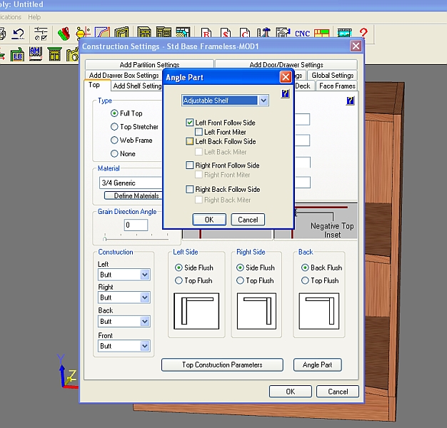

Ok I can get a fixed shelf to follow the angle on an angle cab but not the adjustable. Is this right or am I missing something?
I can take the adj. sheves in PE but hey I'm lazy!!!
Re: angled shelves
Ray,
There is a selection for Adjustable shelves in the Angle Part.
Ray Jorgensen
Posts: 199
Joined: Sat, Jul 29 2006, 9:11AM
Company Name: Classic Custom Wood
Location: NC Iowa
Re: angled shelves
Post by Ray Jorgensen »
I'm home now and I can't even get the fixed shelf to give me the option. Both fixed and adjustable are greyed out. Both in the main section and also in the shelf editor part.
Re: angled shelves
Ray,
You must place a Fixed Shelf or an Adjustable shelf in the cabinet first and then the options in Angle cabinet will work.
Ray Jorgensen
Posts: 199
Location: NC Iowa
Re: angled shelves
Thanks Kerry, I was figuring that since the setting is on the Add shelf tab that the setting had to be established before the shelf was added. Got it now.

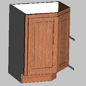

Here is what I am trying to do but the opposite way. This one was done with the part editor but I am sure it would be easier to do it with the proper tools from the program.
Clipped Corner.jpg (13.73 KiB) Viewed 33567 times
Clipped Corner.hsf
(356.02 KiB) Downloaded 2066 times
Scott Marshburn
Posts: 867
Location: Jacksonville Nc
Re: angled shelves
Post by Scott Marshburn »
Hi Denis.
You should be able to accomplish this using an angled front corner cabinet. And a second cabinet with everything removed except for the face frame.
Denis L'Heureux
Posts: 407
Re: angled shelves
Post by Denis L'Heureux »
Well that sounds interesting. Not quite what I want to achieve, I would like the two doors to open together as in a Lazy Suzan cabinet door but I will give that a go and see if I can pull it off.
Thanks Scott
