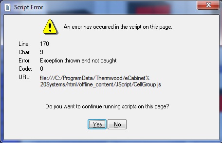

Ive got this message, and can't rename a cabinet

I get a similar message, but it doesn't seem to do any damage. Click continue or close and continue with no apparent effect.
script error.png (18.85 KiB) Viewed 4714 times

Bryan,
Seems that the first setup (V6Build2Setup1a.exe) did not perform a complete overwrite of the Item Window support files. Since some of the files are not paired with the current version correctly, you are seeing this issue.
If you run the current version of the install, I think this problem will be resolved.

Thanks for that Ryan
I did ask if those of us that downloaded the first installer should install the second and Larry replied that it wasn't necessary.
You might need to update that advise.

Hey Ryan
I hate to do this to you mate, but I installed 'b' and am still getting the error.
