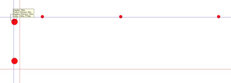

When I create a drawer Front mounting block pattern like this:
Hole Pattern Screenshot
Hole Pattern.jpg (12.26 KiB) Viewed 37461 times

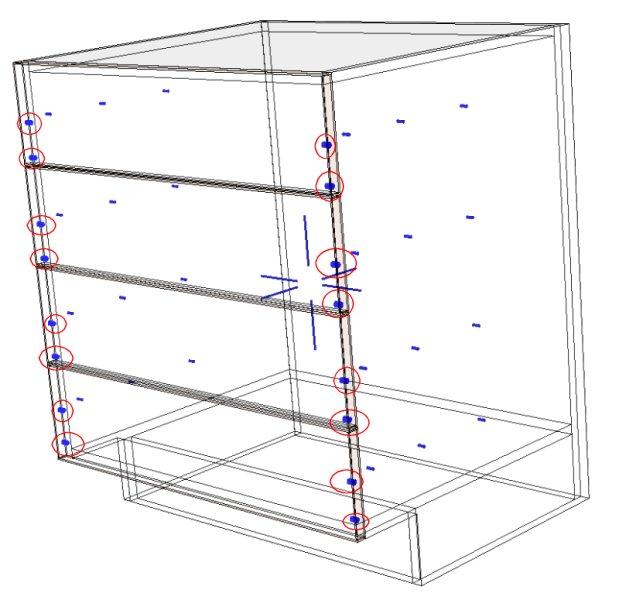

The orientation of the front clip fixing holes is wrong as per the following:
Wrong orientation of Front Fixing holes
Wrong Orientation.jpg (55.29 KiB) Viewed 37461 times
As you can see from above, the front fixing holes are being drilled into the edge of the drawer front rather than the back face
Am I creating the hole pattern wrong? or is it just the program having a bad day?

Hate to tell you this, but what you are trying to achieve is not able to be done. You are not the only person who needs this feature. Why doesn't it work when you can do hinge boring and mount boring at the same time? I don't know. If you look through my posts in the forums, you will see I've brought this issue up more than once. The only thing you can do is to manually put the holes in with part editor and then constrain them. Takes ages if you use multiple different metal sided draws like we do.

**Note - This probelm only exists for people using metal sided drawer systems such as Blum Metabox, Blum Tandem Box, Grass Nova Pro, Hettich Multitech, Hettich Innotech etc.
If the program is applying the holes, but simply orientating them the wrong way, and if as Jason pointed out, the hinge patterns correctly apply the holes into the back face of the doors and the inside face of the carcase at the same time, shouldn't this be a simple thing to fix rather than to simply ignore.
It is an inconvenience to have to apply the hole patterns manuall to the back face of the drawer every time a new drawer configuration is required. It is also very tedious to try to remember (or hit the technical manuals) every time I want to create a new drawer layout on the fly. The relationship between the front fixing hole bracket holes and the runner holes is critical. There is no room for error.
I have created some manual holes for the front fixing clips in the back face of the drawers, and then restrained them, but this is only helpful for the same or similar drawer layouts. If you need to change the drawer heights or configuration, it has to be done all over again. Also when I change the drawer front from one style to another, all of my manually added holes dissappear and I have to go through the adding process all over again.
Could we please have this orientation problem resolved so that everone who ever uses metal sided drawer systems will be as happy as a pig in sh*^. Please Please Please

I have been looking at this and I thought you should be able to place holes in the part editor and constrain them and everything would be OK. The problem I think comes from the multiple reveals that one uses in frameless. You might have one reveal on the right side of a drawer and another on the left. There are also changes in top and bottom reveals so any constrained holes set for one reveal will not work when the reveal is changed. The holes in the drawer front need to be positioned by the drawer box and slide. This would require eCabinets to create a hole pattern in two different axis planes.

Am I correct in assuming that the Hardware Hole editor would need to become a full 3D editor instead of just 2D to be able to accomplish what Sean is wanting to do.
3D view not required. This could be done with the 2D view. The main thing that will have to be decided is where to position the drawer front holepatterns (patterns on the -X side of the axis) from: the drawer front, the drawer box, the side of the cabinet? What if there is no drawer box with the drawer front but it does have a slide pattern?
