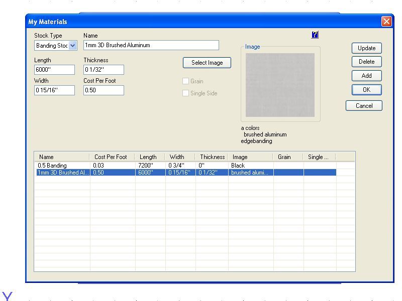

Here is the banding in My Materials.
My Materials.jpg (61.72 KiB) Viewed 6017 times

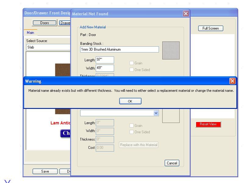

When I try to edit the cabinet I just modified, I get this.
Material Not Found.jpg (39.89 KiB) Viewed 6017 times

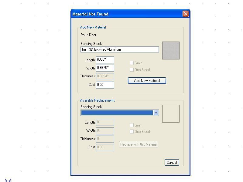

I tried to change the banding of the doors in the Door/ Drawer Front Designer and get the same problem as above. I clicked on Add New Material and I get this:

It looks like the program converts 1mm to 1/32" in My Materials and .0394" everywhere else and the recognizes it as two different materials.
I change the Dimension Display to Inches and Decimal, tried to reload the cabinet, now it was doing the same thing with my OTHER edge banding.
I went back to My Materials and tried to change the material thickness to match and the error message "Too Few Parameters" comes up and eCabinets crashed.

there was a bug in V6 build 1 and 2, where it would import materials incorrectly if you were in factions dim mode.
