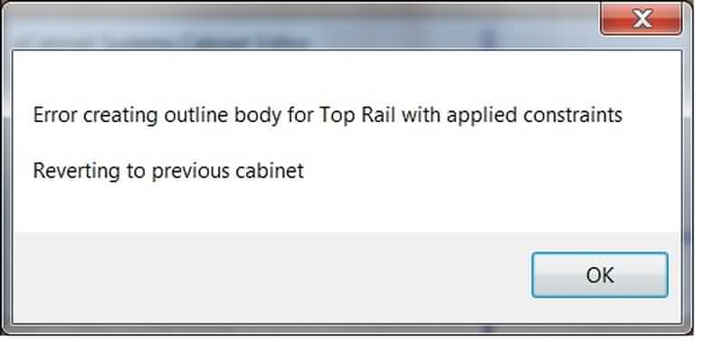

The attached cabinet file seems to be having problems resizing. I get the error dialog pictured here when I try to change the width. I created a top rail 6" wide and then took it to PE to create the arched cutout. I want to make a cabinet from this seed that is 48" wide and I get the error dialog. I didn't think I had to do any CM work to change the size of a cabinet with a faceframe even if I took one of the parts into PE. Is there something I must do to the PE arched top rail before I can make the cabinet wider?

As for your resize issue, what is happening is that in order to keep the left and right sides a 6", the center arch of the circle is cutting the part in two. You can see this happening if you resize to say 35". 36+" wide will result in the error.
To resolve this, I think you are going to have to find a way to make the arc in multiple segments, and then constrain the center to by some point. Currently, eCabinets does not support splines which is really what is necessary for this to work the way you are asking it to.

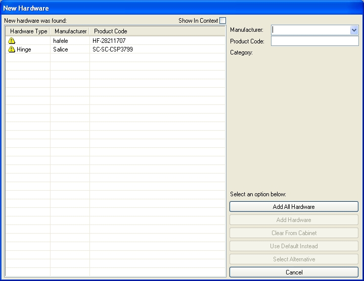

So I guess you were able to open Don's cabinet. When I try to open it in build 3 I get this screen
And when I choose to Add All Hardware nothing happens
I can remove the Hinge from the cabinet but I cannot remove or add the Hafele parts. I have to click cancel to continue and of course the cabinet does not open.

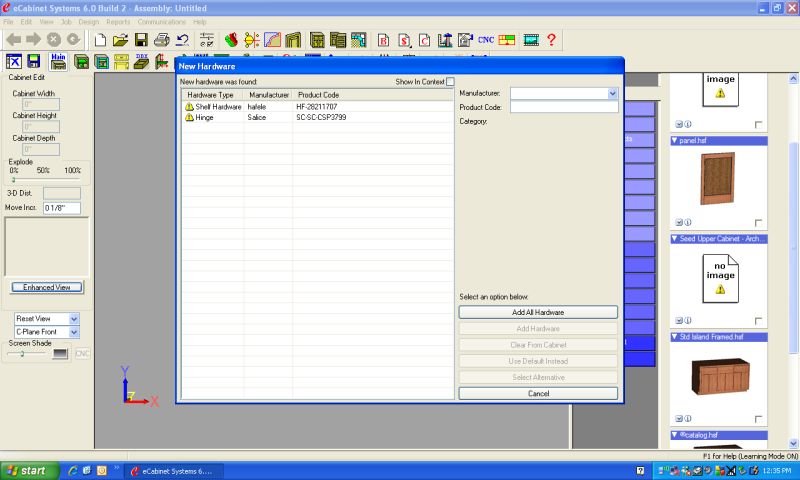

I can open this cabinet in Build 2 where I get this screen (notice that the hardware type shows up here.)

If you will constrain your arch from the top of the part and the node in the center of your arch it should behave like you want.
Try re sizing the cabinet I have attached and see if it behaves like you want.
