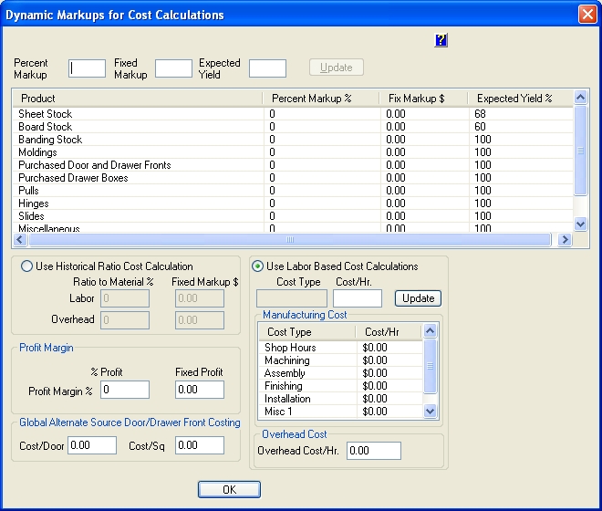

I placed a catalog cabinet in a room priced at $2000.00 When I run a cost sheet I get this
Notice the material price and the rest is Profit/Catalog cabinets
I have no profit entered in preferences
And the total price is wrong any way.
The cost sheet also priced the materials wrong also.
It looks broken to me.
