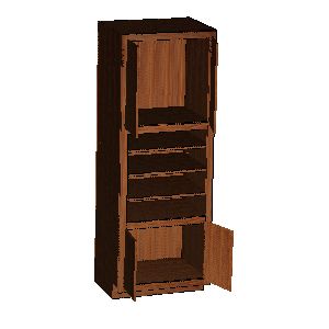

I am trying to change the height on a cabinet (attached) to 94" and I get a dialog box saying:
There was a problem saving cabinet bodies.
One or more bodies may be missing.
Reverting Std Tall Framed open doors-MOD1 to previous cabinet state.
Does anyone have an idea what this dialog box is trying to say to this lowly woodworker? :?
I also got this error, in a recent editing session, when trying to take a standard base cabinet and increase its width from 36" to 40".
Std Tall Framed open doors.jpg (9.79 KiB) Viewed 2579 times
Std Tall Framed open doors.hsf
(458.02 KiB) Downloaded 284 times

Your cabinet re-sizes fine for me but you might try right clicking and choose Remove Part Editor Cuts/From Entire Cabinet and let the cabinet re-generate. This usually fixes the missing part bodies. Of course it will remove any part editor cuts you have also.

Thanks Kerry. I just tried resizing a standard base cabinet and I got the same error. I guess eCabs needs a rest because I've been working it to hard. Shut down, reboot, restart, waist time...... :(
