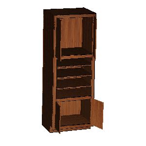

Attached is a cabinet that this happened with. Took cabinet into cabinet editor from room layout editor.
1. Removed all part editor cuts (suggestion from Kerry to enable me to change the cabinet height)
2. Changed the size from 84" height to 90" height.
3. As you look at the front of the cabinet I took the top left door into the part editor and eCabs locked up, causing a Windows invoked shutdown of eCabs and loss of all changes made up to that point.
Std Tall Framed open doors.jpg (9.79 KiB) Viewed 2090 times
Std Tall Framed open doors.hsf
(458.02 KiB) Downloaded 290 times

Donald,
When I take the doors to the PE they shrink down to w: .0725" x L:0.2102" x T:0.714" also when I go back to the CE they stay that size.
How did you make these doors?
