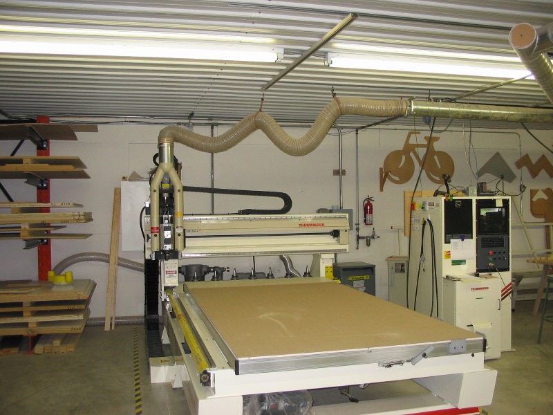

My ceiling is 112" and it is tight, but working. I fastened a sliding door track to the ceiling centered over the table and attached the hose to the trolley. I wish I had about two more feet of height.
Dave Egnoski

That photo gives me some ideas. I do have lots of height when I get out from under the mezzanine. I am thinking of a track that will carry the hose in under the mezzanine with a spring that returns it when the head comes away from the home position???? It might work and the space under the mezzanine is of much less value then the rest of the shop.
