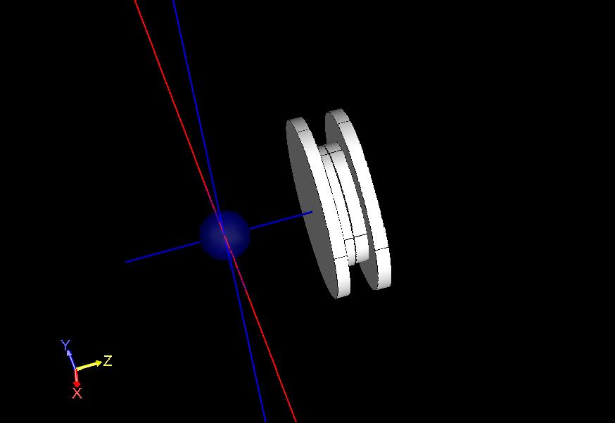

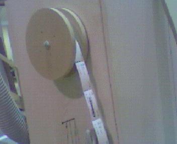

You know how when you print the labels for a really big job and they all just fall to the floor, then you have to pick em up and roll em by hand, takes like 15 minutes to roll up and then your hand hurts and all that fun stuff? I'm sure those thermwood operators can relate to that, well i got sick of doing it so I made myself a label spool, all u have to do is stick one end of the label strip on the spool and it rolls itself. Here's the file.
Just cut 2 of each piece and nail it all together, then mount it anywhere you like, i used a 5 inch bolt and secured it to my storage cabinet.
Oh and make sure you make it out of 5/8\" material, since the labels have 1 1/8\", the 2 5/8\" in the middle make out to a perfect 1 1/4\" which gives perfect room for clearance.
Enjoy!!

Here's another view
