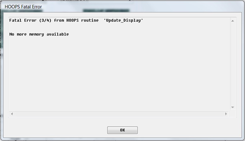

Any one know what is causing this error? I get this from time to time, which crashes e-cabinets, losing all work since the last save.
I've got lots of memory, 9 gigs total, only 3.1 in use at the time of this error. Could this be a faulty memory sdram chip? or maybe the memory on the video card? (Quadro FX3500).... Just a bug in the software? I've got pretty good airflow through a large case, and a Antec spotcool fan cooling the memory, so I can't see it getting hot and causing any problems...
This last time I got the error I was working in the countertop editor, which I wouldn't think would be really that memory intensive...

I think it is serious memory leaks in the Hoops subsystem. I have this problem now and then also - loosing all my work since last also. Really annoying since you never know when it is just going to pop up and loose everything for you.
Since no other applications on my computer have these kinds of problems (Dell XPS, 8GB Ram, quad-core processor, Windows 7 Pro 64-bit) I don't think it has anything to do with my computer. I use graphics intensive CAD programs and video/photo editing programs and they are all fine and have never crashed.

Lately it always seems to happen in the countertop editor, when I click on the 'designate edges button'. Dont know if that is the only place it has happened, but today it is. I am probably running close to 50 : 50 odds that it will crash when I click on designate edges. Strange that it was never like this before.
