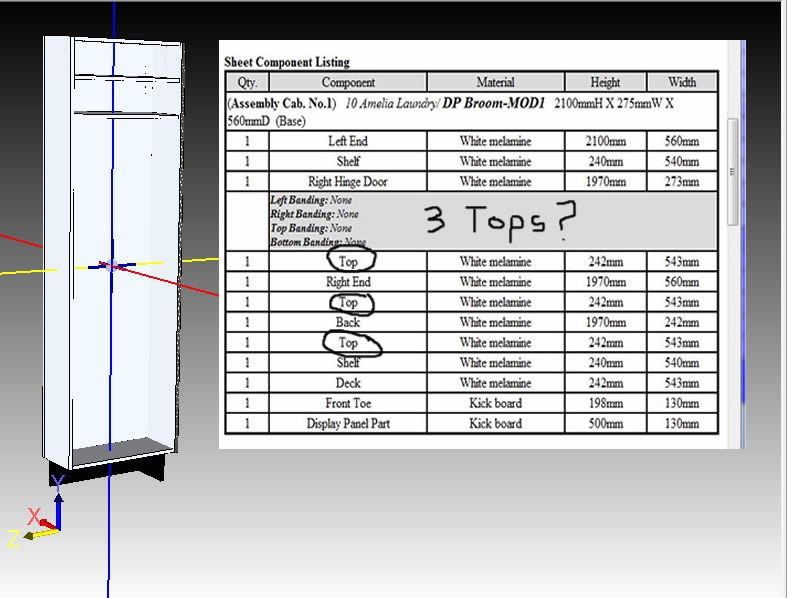

one cabinet 3 tops?
one cabinet 3 tops?
One out of the blue, Three top shelves instead of one.
3 Tops1.jpg (79.18 KiB) Viewed 7094 times
DP Broom.hsf
(474.02 KiB) Downloaded 618 times
Re: one cabinet 3 tops?
Mark,
That is strange. I had to click "none" three times in construction settings to remove the tops so they are really there.
Rick Deskins
Posts: 858
Company Name: Thermwood
Post by Rick Deskins »
This cabinet does somehow have three tops. Can you remember how this cabinet was made or what steps might have caused this to happen? If you highlight the top and hit delete (do this twice). It will get rid of two of the extra tops.
Rick Deskins
Sorry Rick
It was a couple of weeks ago and we didn't pickup that it had extra tops until we were assembling the units. So I am unable to recreate the occurrence.
I posted it more as a curiosity than as an issue or problem.
It seems to be a 1 off
Thanks anyway for the advice.

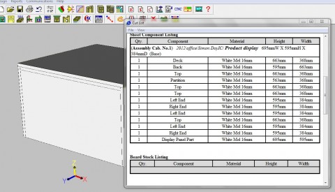

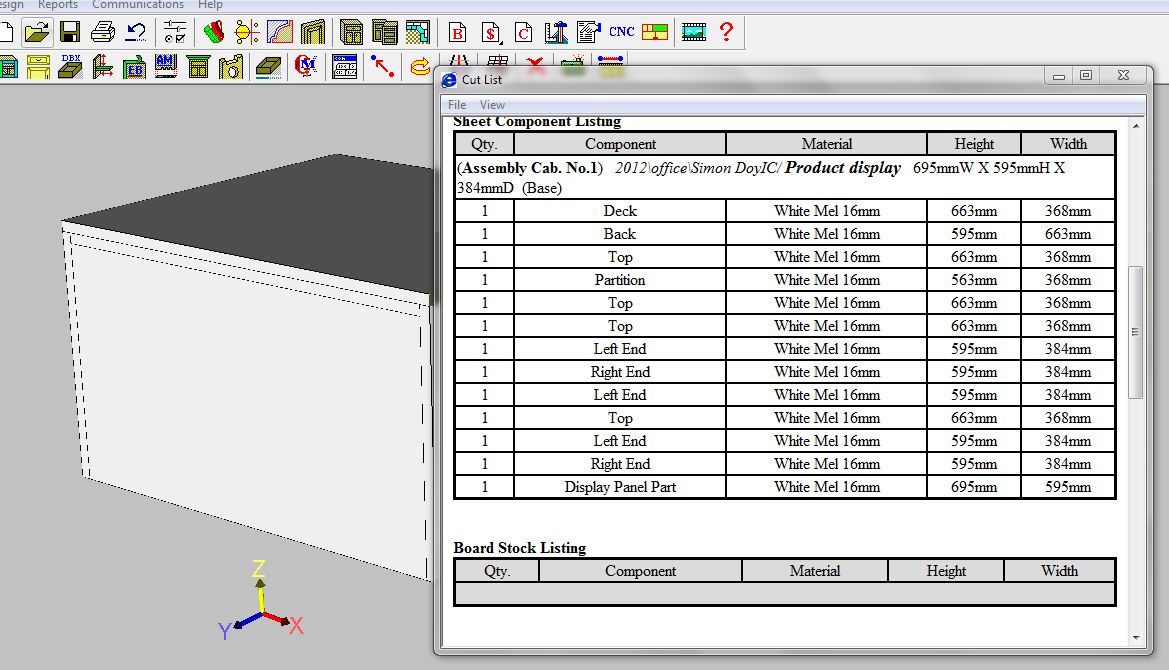

Hi Guys
Just was about to print this one out and noticed some pieces have doubled / trippled up.
I'm not sure how I did it. And painfully I cant remember if I did most of the work Pre or Post upgrade
I notice that there are 4 tops, 3 left ends, 2right ends,1deck and 1 back.
Might be something to do with the saving sequence.?
The snip is of a unit taken from the infected assembly.
Simon1.esa
(1.27 MiB) Downloaded 588 times
Post by Josh Rayburn »
Mark, it's not an isolated incident, I've seen this before. I could not nail it down at the time unfortunately.
