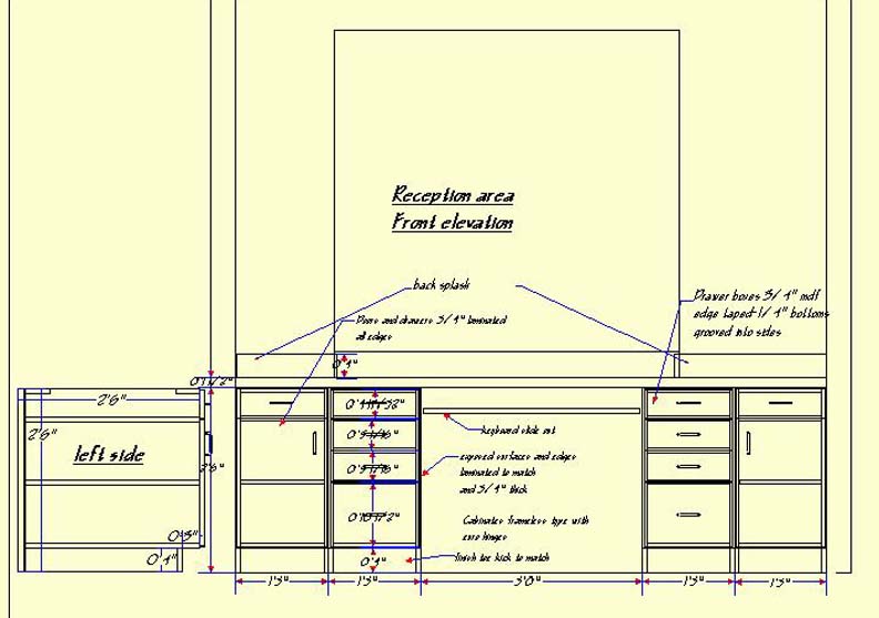

Just thought I would post a line drawing for folks like me that had never used it and so they can see the potential for it.

did you draw all that in line editor or just drop in your cabs and dimension them, that is exactly what i need for shop drawings

That is a wall from the layout that I sent to the line drawing editor and then dimensioned, added notes and copied and pasted the end view.

That page I had the line enhancement setting raised up so that the hidden lines show. You can lower the line enhancement so that you don't get all the hidden lines if you need it. And you can have multiple pages of different views, single cabs or even parts for details.
Funny thing, I think I have posted on this forum in the past about wishing dimensioning was more autocad like, and lo and behold if I had just checked it out sooner. There it was all along.
