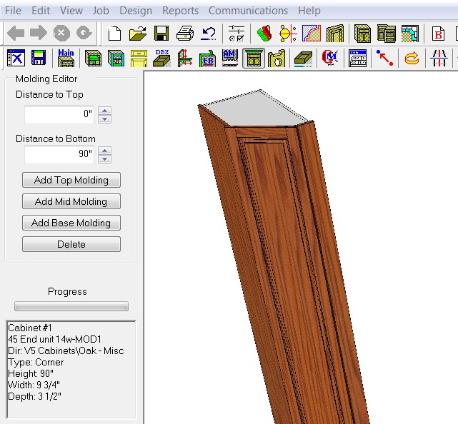

Am I just confused, or should the select molding button not be below the add top/middle/lower molding buttons in the molding editor. I tried downloading and re-installing the latest build. Still not there. Maybe I'm just not looking in the right area.... I rarely change the mouldings that I have associated to each cabinet from my library, but this one has none so I need to add it....
Also wont let me add fixed shelfs in this cabinet. I get the 'change resulted in unworkable top' error. Adding adjustable shelf works fine.
moulding editor09.jpg (91.9 KiB) Viewed 10522 times

Molding selection is now in the item window (right hand of screen). Can you post the cabinet that will not add the fixed shelf?
