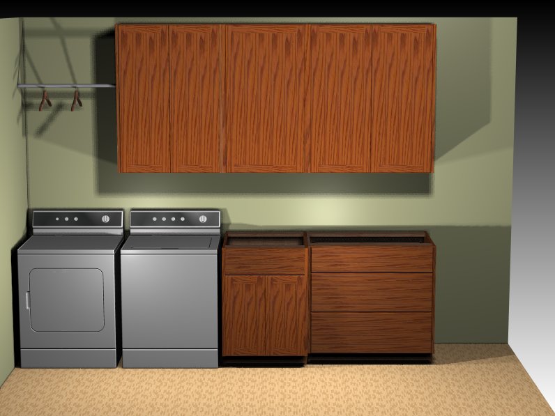

I have 1.625" Face Frames and the client would like to have full overlay doors and drw. fronts.
1.What are the reveals used on something like this?
2.What is the reveal when the two f.f.s butt together?Do I change hinge overlays here?
3.Reveal between drw.front bottom and top of door?
4.Reveal to crown on uppers?
I use Blum clip top hinges with soft close with .5" overlays.I can only get .75" overlay out of these,which will leave 1.5" between butted cabinets and the two door reveals.May look kind of odd.I know I can use their compact 39c hinges which have overlays from 1'-1.56".
If you have any suggestions on face frame reveals and hinge use, I would appreciate it.
Scot

When doing FF cabinets with Blum hardware I normally do 1.5" FF's with .5" door/drawer front overlay with .5" separation between between doors and drawer fronts.
Crown spacing and such is a personal preference for the customer. Some like more reveal (wider top rails) and some like the .5" reveal that equals the door/drawerface separation.
Glad to see someone else using drawers in lower cabinets. Have you thought about corner cabinet having drawers instead of lazy susans? My customers are blown away that they can get rid of lazy susans and have full extension drawers in their corner cabinets.
Just one persons opinion... :D

Yes,I would like to do one.This client wants to put a recycling center in the corner cab on this one.Could you send me some information on making that.
Do you change hinges when you have two cabinets butted together like the uppers?Because then your spacing would be 1" between the doors.

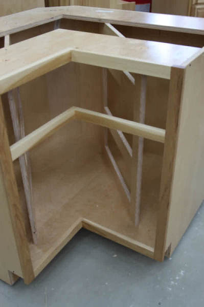

This is my favorite way to do the corner drawer. I run a ledger on the wall for tops, For all practical purposes that space is wasted in the corner with a Lazy Susan or blind corner pull out also.

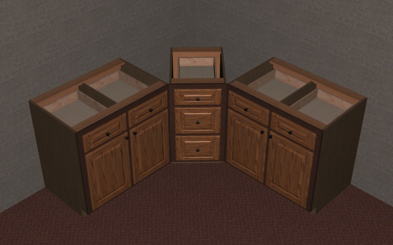

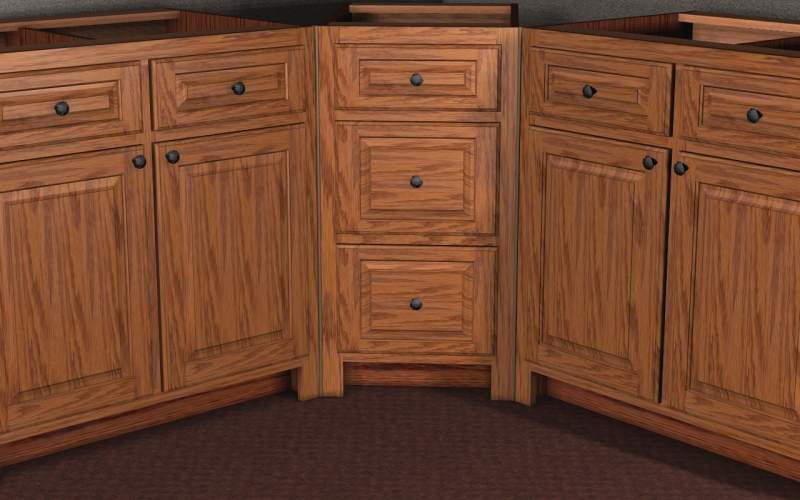

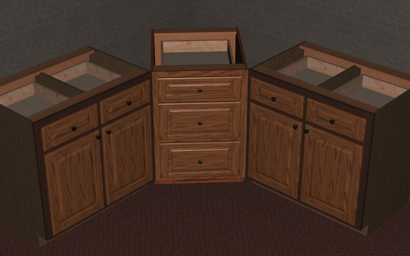

Here's how I do corner cabinets with drawers. See pictures.

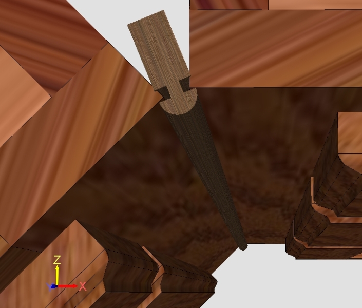

The nice thing about this is you can make it whatever you want, depending how much wall space you want to use. I try to keep them close to what a regular 36" x 36" corner would be. (approx 18" cabinet) Here is a 24" cabinet. You can make these 28" deep if you want that much drawer.
I make a small bead, 3/8" thick with a slight saw kerf ripped into each side that the corner of each cabinet face frame slips into to join these. This allows for adjustment if the room corner is out a bit and adds a nice detail. No mitering face frames. I run a 3" scrap along the top of the corner cabinet to the wall ledger to secure the cabinet in place.
This also makes for a nice cabinet to have a drawer above and a two can waste pullout below.

I like Kerry's plan for an angled front corner drawer setup and I have used this on a few occasions when this was the customers preference. The design I have posted is for customers who don't want the angled front but want the corner front.

I like that idea Kerry, and the look too. I don't quite understand the bead though, if it's not too much trouble can u post a detail of it. Thanks
Re: Full overlay on Face Frames
Terry,
Here is a detail of the bead with kerf cuts.
When installing the cabinets I put a Little glue in the kerf cut then attach the bead to the first cabinet with a headless pin. I then place the corner cabinet face frame in the kerf cut then attach the second bead to that cabinet. I then butt the third cabinet in place and make adjustments to the corner and fasten all. The cabinets pressing together trap the bead in place.
It adds a nice detail to the corner, allows me some adjustment and eliminates the problem of aligning mitered face frames.
