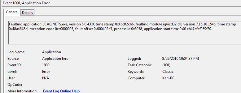

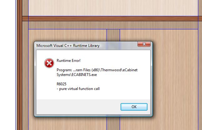

I am attaching two screen captures of the error message that I get when I try to select a drawer box in the drawer box editor (Microsoft Visual C++ R6025 - Virtual function call). The software seems to work fine other than this error. I followed a link found in another post (http://www.thermwood.com/forums/viewtop ... 025#p57684) suggesting a fix for the same error in a different context, but found only a hotfix for microsoft visual studio. Does anyone have any ideas? I appreciate any suggestions as I'm anxious to finish the video tutorials and begin using this software. Thank you in advance for your time.

ig4icd32.dll is a dll that deals with your video card. You should update the video card driver and see if you still get the error.

Thanks for the tip. I finally figured out that I could select the drawer box just fine when the opening is defined by a case part and a shelf, but not between a case part and a stretcher as I was trying to do. I'm not sure if it should be doing this, but hopefully a lot of these issues will be resolved when I upgrade to Windows 7.
