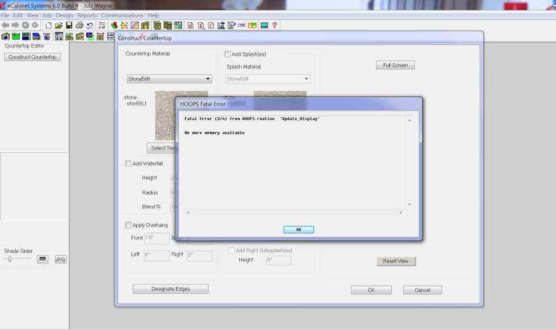

Does anyone know why I would get this error every time I try to add more than one CT??

Anybody???? I keep trying but it happens everytime I start the second CT.

Wally,
I have had this problem as well.
The work around I use is to place one countertop, save, exit ecabinets, load the job, place the other countertop.
I think the guys at Thermwood are looking into this error.
Hope this helps. :beer:

Thanks Bryan -- That's what I ended up doing.

Wally,
Can you get me a job and some steps that you take to get this to happen. I cannot reproduce this.
Also:
What Operating system are you running on?
What Graphics card are you using: (Make, Model and memory size)?

Scott -- I am running Win 7 32 Pro and my card is a Nvidia Quad FX570. I haven't run into this before so I'm thinking it is a present problem. I will attach the job for you.
