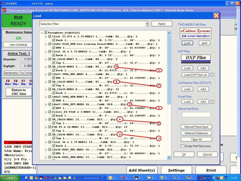

Can someone take a look at this and let me know if it happens to you?
1. Load twd (notice that all the quantities on the second line have been changed to 1)
Does anyone have any idea?
-John
Quantity Error.JPG (117.17 KiB) Viewed 28126 times

This is by design to clarify quantities. It was mentioned in the items for this release.
Cabinet quantity acts as parent over part quantity in Load screen. (ALTERED)
The cabinet quantity takes precedence over part quantity. For example, referring to the image you posted, if you change the Deck part quantity to 3 for the cabinet SA_12.36-MOD4 you would end up with 9 Decks in the nest.
Have you checked the results after nesting? Are you getting the correct quantities in the nest?

JohnLashuay
Posts: 645
Re: Quantities in CN Changing to 1
Post by JohnLashuay »
Thanks Larry for the clarification. It looked odd to me, but now it makes sense.
I have checked the quantities on cut jobs and it does come out right.
-John

Me and my big mouth. I just installed it and checked if the quantity issue has been fixed. At first it seemed no but then I read this one and I found that everything was correct.
I do find it confusing that the part quantity is set to one although you are cutting 4 cabinets (for example). When I posted my original finding I was confused that you can get negative value for a part quantity. So that's why I suggested that the cabinet quantity should always overwrite part quantity. In CN 5.58 it seemed that cabinet quantity was subtracting from part quantity to get the right amount and that's why you could get negative value.
CN 5.59 seems to be working right though. So I will shut up and you guys decide what is confusing and what not.

I understand how this helps with the twd files, they are cabinet based. It also happens when loading an xls cut lists which does not have parts in cabinet groups. I had to downgrade back to 5.58 until the issue is resolved with xls.

After lengthy discussions weighing the pros and cons we believe we have a new solution to this issue. Since the parent/child technique is too confusing and the filter quantities from eCabinets are not being passed correctly we will go back to the old way of displaying the true part quantities in the Load screen and remove the parent/child relationship. Here is the new aspect. Now a change to cabinet quantity will alter the part quantity accordingly and maintain any difference that may exist due to the part quantity being a different value than the cabinet quantity. This means that if you increment OR decrement cabinet quantity the part quantity will maintain any difference between the part quantity and cabinet quantity. It will also avoid getting a negative value. If the difference amount results in the part quantity to go negative then Control Nesting will simply make the quantity zero.
An additional aspect to keep in mind with this strategy is the cabinet colors that are printed on the labels. Now if extra parts are needed, they will get the cabinet color for the the last cabinet in quantities that get assigned a color.
