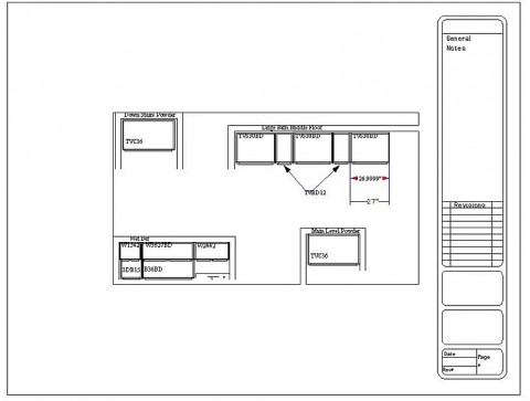

Ok, I attached a job I just got for a lodge. I am doing it out of box cabinets and don't really need a 3d rendering system, just overhead line drawings. Here are my issues with the lde.
1. The whole interface needs a name plate like how autocad or similar programs have. Something that can be turned on and off or maybe an option to use or not use. I hate having to make a little area for each individual overhead and adding all of that information.
2. Typesetting is terrible. If you print out page 3 of the overhead in the attached file the font is not the same size as the displayed font.
3. Appliances do not print right. They are missing halve of the lines associated with them.
4. Look at page 3 in the lde, I swear that cabinet is not 26.9999" If you go the the main view and zoom into the cabinet, you can see that they are not really touching. Infact I could go for a user editable between arms... as you can tell the cabinet is labeled a 30" box, but the cabinet is 27", so something I could type whatever number I want to in would be great.
5. Cabinet names. I did my best at lining the names of the cabinets up, but they are not perfect. Having a naming feature that would print out the names associated with the cabinets would be great.
6. I get disconnected cabinet lines when I print most things from the lde, Like half the page will be shifted a pixel or two.
I hope no one downs me for using box cabinets. We are really thinking about shifting our production and getting our face frames and doors from china and domestically making the boxes. So in essence we will be needing a router for the cabinet parts and I want something that can produce nice quality line drawings.

Re: LDE Frustrations
Lesley,
I know that Thermwood is planning on improvements to the Line Drawing Editor but I don't know the time frame.
It looks like most of what you are talking about are not bugs but feature requests.
As for your list:
Maybe this will help until the improvements arrive.
As for your list:
You are asking for a Title Block. You can search the forum and find much about this. Architects create these using their CAD program and save it as a block to be used over and over. HERE is a link to a thread that has the block I used in your drawing below and how to use it.1. The whole interface needs a name plate like how autocad or similar programs have. Something that can be turned on and off or maybe an option to use or not use. I hate having to make a little area for each individual overhead and adding all of that information.
When I print your drawing the fonts seem OK. Check your printer settings and print drivers. I don't know what else would cause this.2. Typesetting is terrible. If you print out page 3 of the overhead in the attached file the font is not the same size as the displayed font.
Try adjusting the Line enhancement in the LDE to a heavier Line weight. This should correct that problem.3. Appliances do not print right. They are missing halve of the lines associated with them.
As you see in the picture above I get 27" when I measure your cabinet. This can happen if the Room Gets skewed a bit before doing a measurement. Hit the reset view button if this happens again and see if that helps.4. Look at page 3 in the lde, I swear that cabinet is not 26.9999" If you go the the main view and zoom into the cabinet, you can see that they are not really touching. In fact I could go for a user editable between arms... as you can tell the cabinet is labeled a 30" box, but the cabinet is 27", so something I could type whatever number I want to in would be great.
I agree. This definitely needs improvement.5. Cabinet names. I did my best at lining the names of the cabinets up, but they are not perfect. Having a naming feature that would print out the names associated with the cabinets would be great.
Once again check printer settings and make sure you have the latest drivers installed on your printer.6. I get disconnected cabinet lines when I print most things from the LDE, Like half the page will be shifted a pixel or two.
