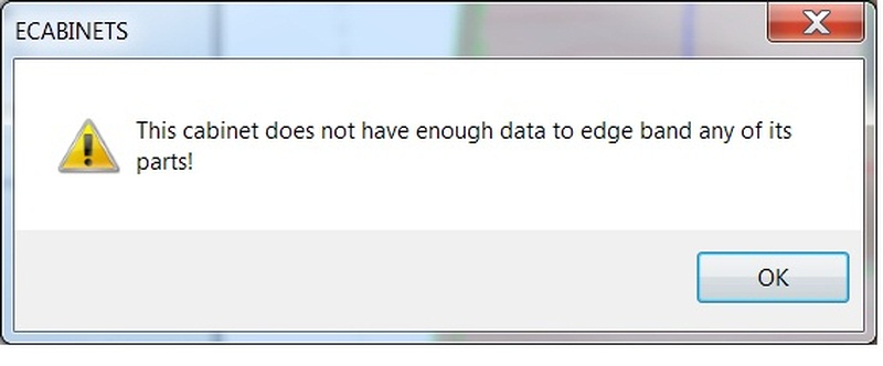

When in the dbx designer there is a button to add edgebanding. However, when I click on the button I get the following dialogbox. Any ideas?

Hi Donald,
Select the drawer box, then right click and "remove all part editor cuts from entire cabinet"
then you'll be able to band it.
Your drawer box lost part bodies for some reason, and that procedure will rebuild them.

Thanks Josh!
I'm always wondering how things get messed up and using the remove all part editor parts from cabinet restores things back to normal. It seems that eCabs is occasionally adding, or losing, stuff without our knowledge. :(
