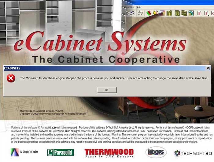

I can not open e-cabinets. I get the attached error message. I am not connected to a network. This is on a laptop computer. There is no one else on the computer. To try to fix the problem I have reinstalled version 6.5 and I get the same message.
Thank you to Thermwood tech services ( James and Scott ). I am up and running again. I had a corrupt hardware file. I had to first delete ecabinets then reinstall.
