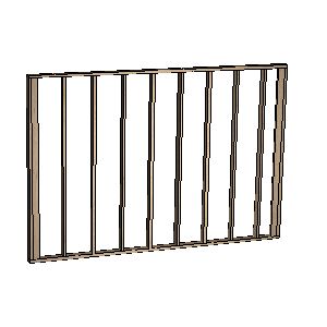

In your opinion what would be the best way to draw a 2x4 wall?
Do you think display cubes would be the most efficient ?

Create a material 1.5" thick and then I would use a cab with partitions and stretchers. Here is an example.
2 X 4 stud wall_8ft.jpg (11.85 KiB) Viewed 4251 times
2 X 4 stud wall_8ft.hsf
(302.02 KiB) Downloaded 434 times

Thanks Scott,
I just keep forgetting that a cabinet can be the start for almost anything
